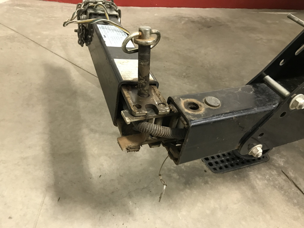

If it's not for a hinged tongue, it's probably to remove when backing up a hill. Mine has a thing like that and when I remove it, the trailer brakes won't activate - useful at times.

The pin is required on surge brakes, not electric, and it looks like it may have been removed on the tongue in the OP photo.

Surge brakes lock-out pin, old style. It keeps the actuator from engaging with the ball hitch.

I think it may be a mounting hole for a power winch. Someone saw that hole and decided to drop a pin it it. It is a good spot to store the pin for the drawbar in a receiver hitch. BTW, I made the mistake of leaving my drawbar in the hitch for too many years once and it cost me about 4 hours of beating on that drawbar with a 4 lbs. Engineers Hammer.

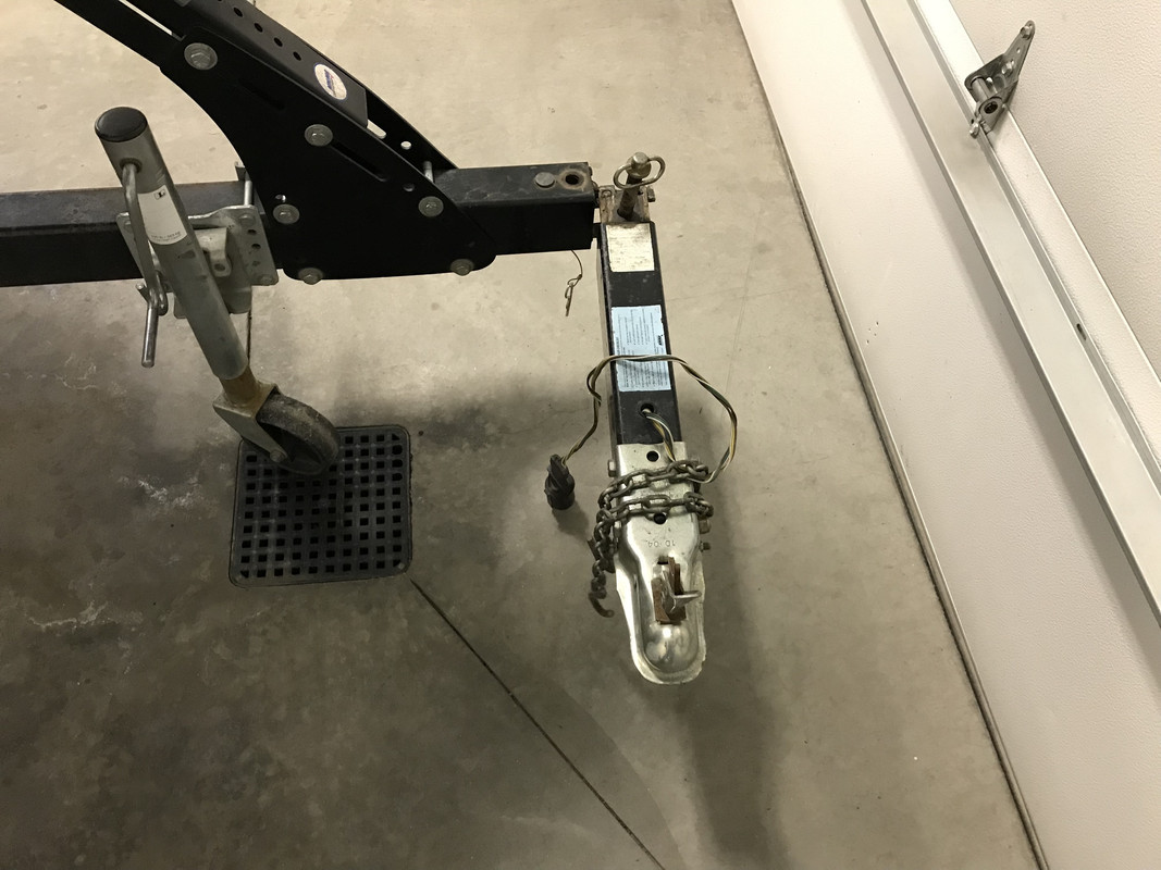

Joe123 was correct. I've never seen one of this design.
Kinda a complex set up. I need to clean it up The grease is old n hard.

Interesting. That looks like an incredibly small hinge point that, along with the pin, is carrying the load. I guess that's only about a 2,500-3,000# rig though, so probably not a huge issue?

I agree.....never seen a hinged trailer tongue quite like that.

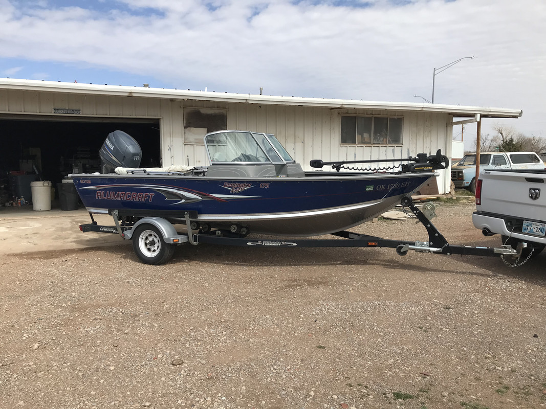

No trailer brakes, so the trailer and boat are under 3K. The boat is under 1500 lbs.
Posts: 438 | Registered: February 17, 2010Reply With QuoteReport This Post
Hillbilly Wannabe
Nice rig there Colorado! My much smaller Alumacraft is 39 years old and still tight and dry as a bone. Happy fishing.

It’s as big as the pin holding the hitch in the receiver.
_____________________
Posts: 5907 | Location: Ohio | Registered: December 27, 2008Reply With QuoteReport This Post
Well that explains why there’s no visible pivot point. Looking back at the first picture, I can now barely make out the split. That area looked like one piece the first time around.

Thanks for the updated pics... nice to see the workings.
