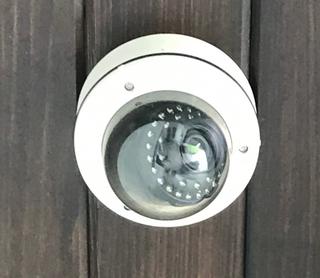

I want to upgrade my security system. I have these cameras mounted around the exterior of the house. They are hard wired into a power supply and analog DVR inside the house.
They are fairly low-res compared to current state of the art and don't pan, tilt or zoom, and I wanted to look into upgrading, but the new one needs to be compatible with the existing wiring because rewiring is beyond my capabilities. I also don't want wireless cameras because I don't like the idea of the cameras being dependent on the state of power and wifi.

I have BNC cabling. It's not Power-over-Ethernet. The DVR is ethernet cabled to my router for remote access, but the cameras are not ethernet cabled.

Upgrading is dependent on your DVR.
Assuming this is an analog CCTV system.
These systems are not universally compatible with others.
Most are either TVI or CDI and cameras are not interchangeable.
Older systems (DVR part) may not be able to understand and accommodate upgraded versions that now support higher resolutions and/or additional camera features.
But they might - so check with your DVR manufacturer for details.
Many newer CCTV (analog) systems now are also able to use some IP cameras and newer HD-Analog cams - but all is dependent on the DVR.
An IP camera only system use a universal standard (ONVIF) that makes them all compatible with each other and computer systems.
So I would stick with your same manf for info on upgrade info (if at all).
