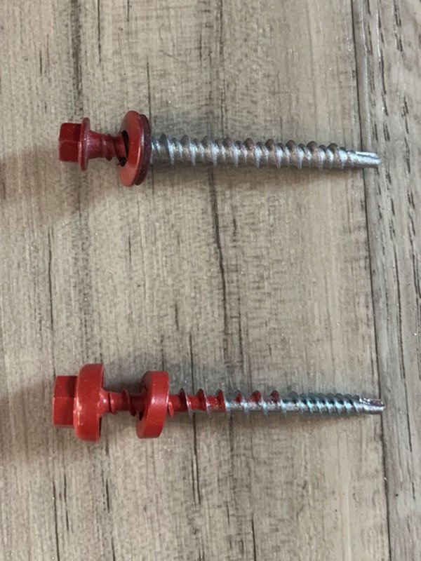

Yes paint over Galvalume, unfortunately I'm pretty sure that's not what I got 21 years ago. This roofer didn't believe so either because some panels are starting to rust at the edges. He also mentioned that he's never seen the little steel screws used for roofing where he came from, but noticed those fasteners were used a lot around here. He also mentioned screws get a pretty good bite in plywood (better than OSB) as long as the plywood is at least 11/16", but he's never had a screw back out when screwing into solid wood so insists that purlins are the way to go.

About 7 years ago I did have a claim from snow when 20" of the stuff was on the roof. When it started to melt the plastic snow guards couldn't hold it and the whole mass slid off shearing off the snow guards and vent stacks in the process. That's a problem I wouldn't have with shingles and when brought up the roofer said they only use metal guards because plastic ones degrade from sun and become brittle.
I found this image which contrasts the cheap screws my builder used compared to ZXL wood binder screws the roofer uses.

I installed the rib roofing on my house about 20 years ago and have also noticed some of the screws on the side that has osb under it backing out.... I actually ordered 24 gage metal for ours and this required pre-drilling holes before putting the screws in.....
