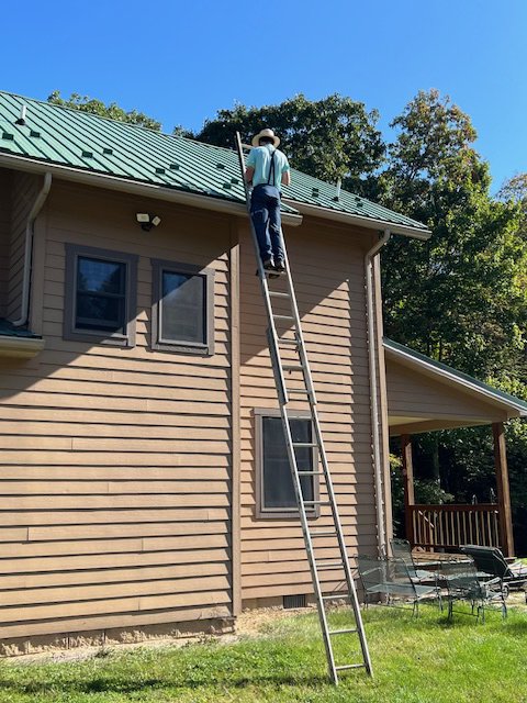

I'm having the 22 year old metal roof on my house and garage replaced and am going with shingles. The roofer generally uses Owen Corning 30 year architectural but will use any brand I want. He feels all the 30 year shingles are similar and should last at least 20 years but probably not 30. The reason he uses OC is simply because they have a reinforced nailing strip which some others do not. Is there anything better in the way of shingles?

Thanks for sharing your thoughts guys, I think I'll just go with OC Duration.
Regarding why does the the metal need replaced and why replace metal with shingles are good questions. The roof was put on when the house was built in 2002 and I thought I was getting a Galvalume product but I don't believe I did because the finish started dulling down within 10-12 years.
At the time the good standing seam, metal roofing was going to cost 3X what the cheaper, exposed fastener, rib roofing, that I went with. Most metal that's used around here is the rib stuff so I figured it must be ok and went with it. Critical is the type of screw used, how they are put in, and what they are put in to, and all three were not right in my case.
What's happened is the screws are rusting from being scratched from the drill socket drivers. Also many are backing out from the neoprene washers. My first thought was to have all the screws replaced, then clean and paint the roof, so I found a roofer who specializes in metal (but uses shingles as well) to look it over.
He said it should not have been applied directly to the 3/4" OSB because screws don't hold that well in it, they should only go into wood and he would cover the OSB with strips of 2 x 4 purlins to fasten to. Also he uses larger aluminum screws with an umbrella head which completely covers the neoprene washer to shield them from the sun. He only uses Galvalume roofing, so with this in mind I had him price out replacing it as stated with rib metal, also with standing seam, and then also with shingles. The house itself is only 26' x 30' but then we add the 2' overhangs, bump outs, 6' x 20' porch, 10' x 26' and 10' x 16' porches, and a 24' x 36' garage/carport. This image shows most of it other than the large porches are on the far corner. Anyway the ribbed metal came to $14.5K, shingles $13K, and standing seam (because of all the trim pieces) was going to be over $40K
One thing I didn't like with the metal was the additional 1 1/2" thick eves (because of adding purlins) particularly the gable ends. Also the 3 year old shop which is across the drive has shingles and it'd be nice if everything matched. I don't get high winds because the pine stand on the west behind the shop blocks much of it.
I can still change my mind but I'm pretty sure I'm going with shingles.
