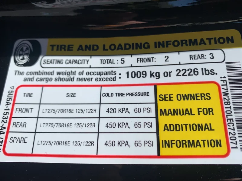

This is the sticker that lists your payload:
That particular sticker is from a 2020 diesel, short bed, crew cab, 4x4 F250 Lariat. Subtracting the 2,226 from the 10,000 GVWR give the as built weight of the truck at 7,774 pounds. That’s probably close to what your truck weighs.

Interesting, that payload info is not on my sticker. Maybe the truck weighs more then and the charts I’m finding online are false. It makes it hard to know what’s right and wrong info out there that’s for sure, but the sticker on a similar truck should be more accurate I’d think.
With payload at 2226# then I’d be unable to even have all my family in the truck while pulling, which seems not right. If I’m able to pull per Ford specs up to 14,700# via gooseneck, how in the heck would keeping away from that top end number by almost 2000# still get me such a low number left over to not get even 3-4 people let alone any gear?

There’s two stickers. The one has the GVWR and GAWR. The other is the one in the picture above and your truck has that sticker as well. Front driver’s side door jamb, maybe on the edge of the door itself. I just checked, and both are on the door jamb on my truck.
Also, what tire pressures does it list?
What size wheels do you have, 17”, 18”, or 20”?

You guys were right I found out my payload is actually just under 2200# so that must mean my truck is about 7800 ish #. This is sort of deflating as with the trailer hooked up I now don’t even have weight left over for more than 2 people and that’s even without any baggage. So not sure what to do. May have to scale back trailer again or would have to get a different truck with better payload and at least same towing capacity.
