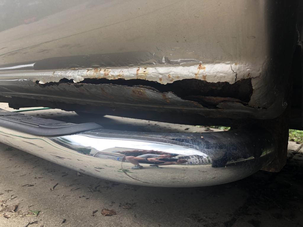

Though it is a Chevy and Chevy trucks are known best for their piss poor pinch welds on the rocker that just welcome moisture and breed rust.
This summer around 94k miles the rust finally showed itself.

But that rust had to be stopped. I wanted it done right no slip on cover rockers but actual new rockers and cab corners. Took it a few places and was quoted $2800-$3400. Boy wanted it done but did not really have the spare cash for that. I was talking with my cousin and my grandma and grandpa have always been good to him and he knows what the truck means to our family so he offered to do it for $800. Not much over parts and paint supplies. Could not pass that offer up.
Got the truck back today and man does it look good!!!!!!!
A little late for good pictures tonight of the rockers themselves so I’ll get some tomorrow but he did a great job. Matched the 20 year old paint great. There is a slight texture to the paint below the mouldings as he coated the new rockers and cab corners with bedliner before painting to better protect against future rust.

The rust spot is very common for that year model. Up till recently I had an 02 Tahoe and it rusted out on both sides there. I had a couple of body shops look at it, and they told me they could fix it, but it would likely rust back out.

Not just that model year. That whole generation and the one prior. The rockers are pinchwelded underneath and the water collects under there.
