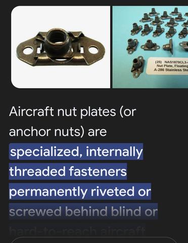

Rivet on some nut plates.
McMaster Carr, or Amazon.

If the hole is going to be close to the edge of the panel, a clip-on nut plate could be an even easier solution.

Rivnuts or nut plates. Used them all the time when I was fixing airplanes for a living.

Nutplates are also a possibility depending on the application and only require pop rivets to hold them in place.
