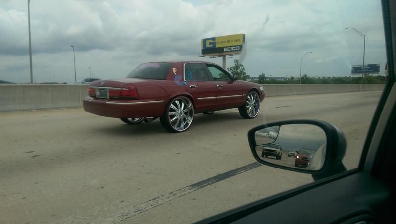

I vote going the donk route, i.e. a lift kit with 33s.

Complete with curb feelers and Ben Hur center caps?

I have a suggestion...
