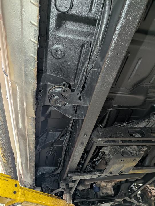

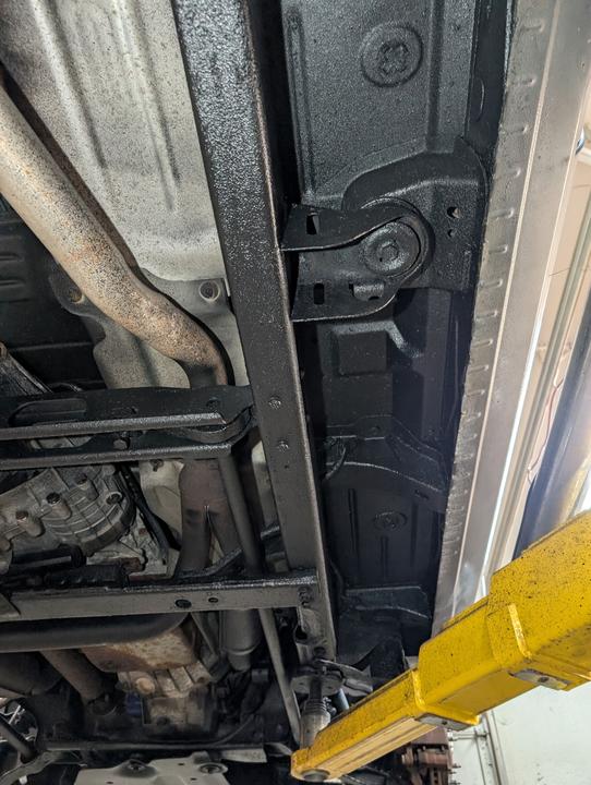

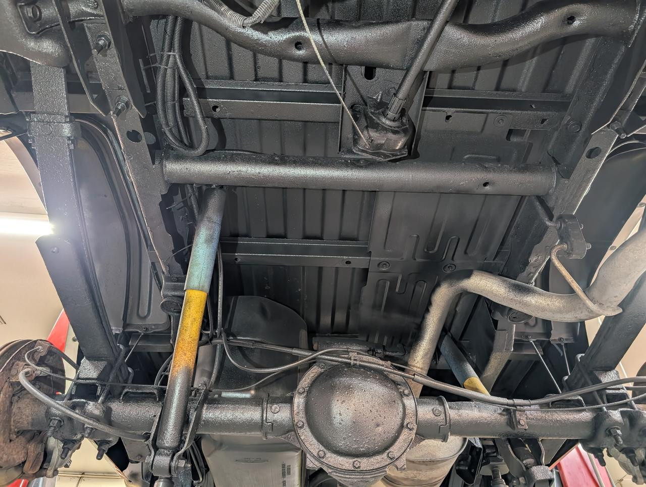

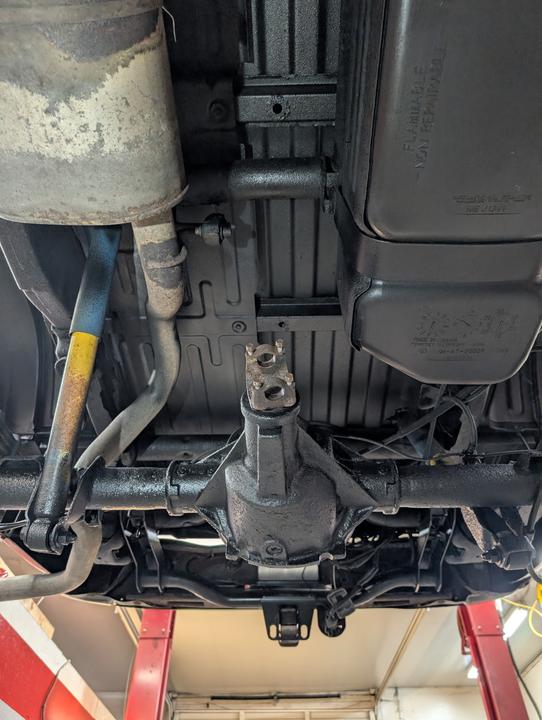

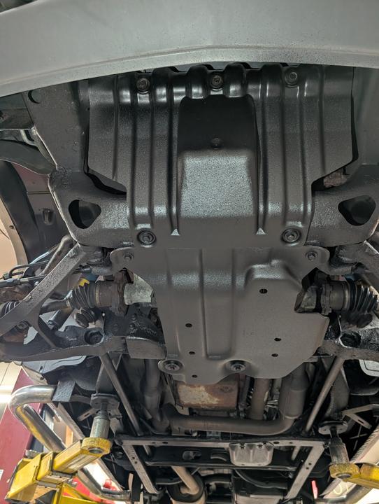

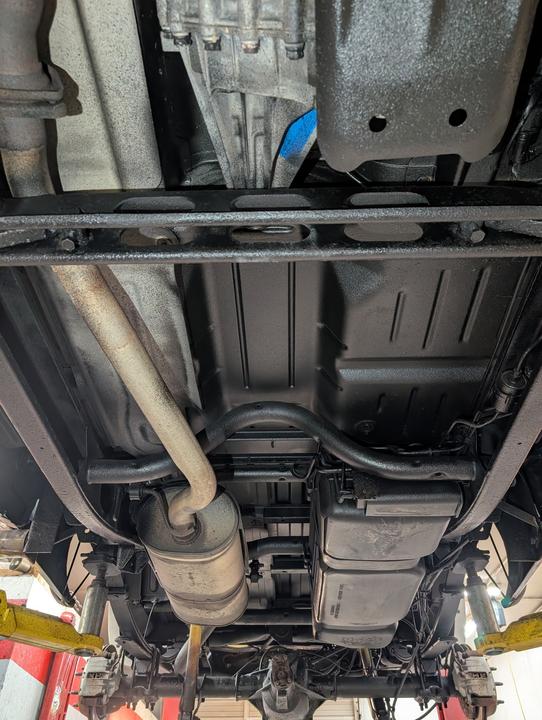

2000 Silverado undercarriage had a fair amount of rust that needed attention and I just did not have the time.
Finally broke down and had it professionally done. All the rust was wire wheeled and cleaned up. Then a mixture of Raptorliner and flex agent was applied.
In October or so they’ll check over it again and any places that may have been missed or seem to need another application will be done.

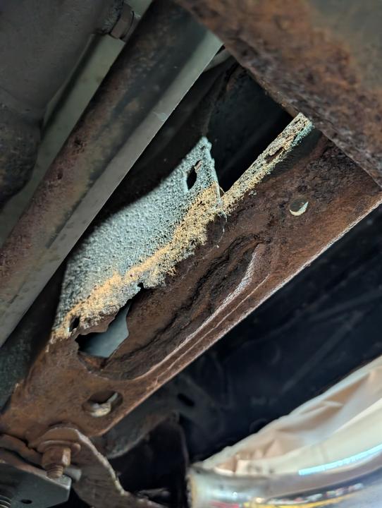

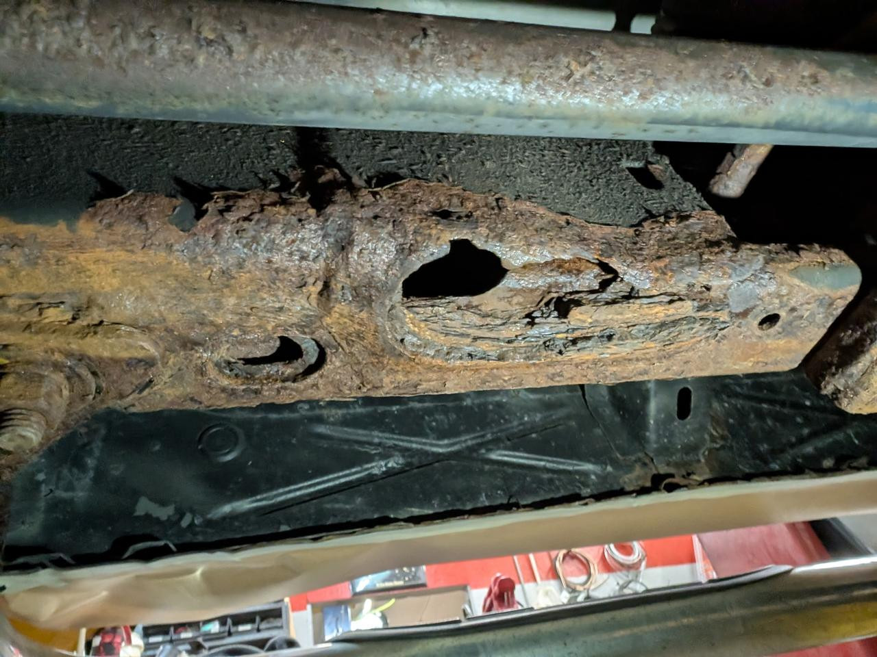

They found a soft spot in the frame that would really have been just fine cleaned up and coated but it was right near the front jacking point on the frame so I had them repair that portion of the frame properly before coating. That way if I were to get a flat on the side of the road and have to jack that area up there would be no issues.
Very happy with the work. They took the time to remove the spare tire and drive shaft so they could spray everything evenly.
Had to have the rockers redone a number of years ago. Yeah time for new shocks I know. They’ll be replaced in the Spring.

That looks great!

I priced out renting all the equipment and the amount of dry ice to do this before coating. Quite costly. Way more than what this cost me.
The cost was just not worth it. If it were a show truck or a full restoration maybe.
This was my grandfather’s truck so it’s just a piece to piddle around in and enjoy.
And this coating will last and prevent further rust for a very long time.
