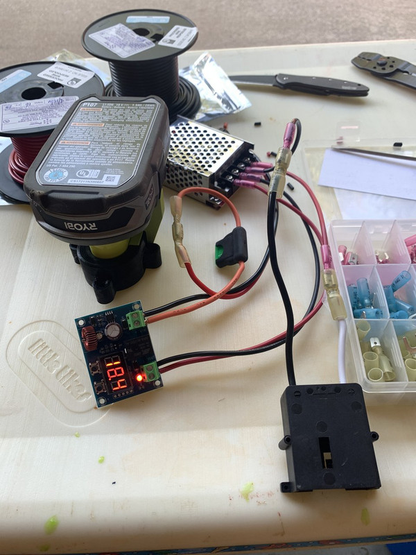

Yes I bought an adapter for my Ryobi 18 batteries and wired in a circuit breaker and use and motor controller along with voltage protector.
I ended up swapping to a circuit breaker as it would pop the fuse when the boys ripped it at full power for a bit.

Black that looks like a familiar mod video setup I saw on utoob, how long did your kids get in go time with the tool battery setup. I see the advantage is if you have plenty of 18V tool batteries around to swap out and keep it running.
Where did you get the voltage readout unit.

It varies on battery size and how much juice but for the most part it lasted just as long as the power wheels battery.
I have a ton of batteries but I bought 2 ghettobrand 6.0ah batteries off EBay and that gave plenty of juice especially since my charger charged the batteries in 30 minutes.
If you are on concrete you’ll rip through tires quick unless you add some rubber to them.
