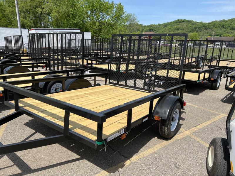

I need to get a utility trailer for my rail speeder I bought. Unfortunately it needs to be 6' wide which eliminates all of the economical 5' wide trailers. I'm likely going to go with this one from Tractor Supply:
6x8' trailer
My question is, unfortunately it doesn't come with anchor points pre-installed. What would you recommend for anchor points? Can I use the ones that slip into the stake pockets like this one? Stake pocket D-ring
Or should I bolt anchor points to the wood floor? The cheaper Carry-ons apparently only have the wood floor nailed down so I was a little concerned about that.

I don’t see where you could add the D ring post.
What about drilling a 1/2” hole in the middle of the lower angle and bolting on a 3/8” eyelet? Drilling in the middle should not affect the structural integrity of the angle.
If the wood is nailed on, not screwed, I would not trust it for a tie down

I'm not seeing any stake pockets on that trailer

I knew I forgot to type something. Going with 1300lbs as a safe bet. Probably less but just in case. And you're right, I thought this model had stake pockets but it apparently doesn't.

If the frame is made out of C channel you can use straps (or chains) with a J shaped hook on the end to hook under the frame edge and up and over.
This is sometimes done on commercial loads so you should be fine.
Another thing I would verify is if the inside width is actually wide enough to load your product. Sometimes the specs can be a little “off”.

You can't use the rails? Maybe with strap tie-downs rather than chain to keep from scuffing up the paint?
Otherwise, I'd get a few D-rings welded to the frame in strategic locations. Maybe an excuse to buy a welder if there are any ambitions in that direction.

Do not use the deck as an anchor point. Go to the frame or rails of the trailer.
Originally posted by 95flhr:
I own and use the stake pocket d rings on a car trailer I own, I would have no issues using them on that trailer.
Uhhh, there are NO stake pockets on 'that trailer'...In order to use stake pockets, there must first be stake pockets! Just sayin' Wink

I have the same trailer there are multiple anchor points welded to the side of the frame or there should be.
They are hard to see even when zoomed in on the picture but there is angle iron welded on the frame in multiple places.
Also all I’ve the uprights from the frame are angle iron and you can use those as anchor points.
This picture look at the green strap on the front left corner one of the angle brackets is welded there.
There is one on the opposite side should be two more on the rear and OME by the wheel well or light.
