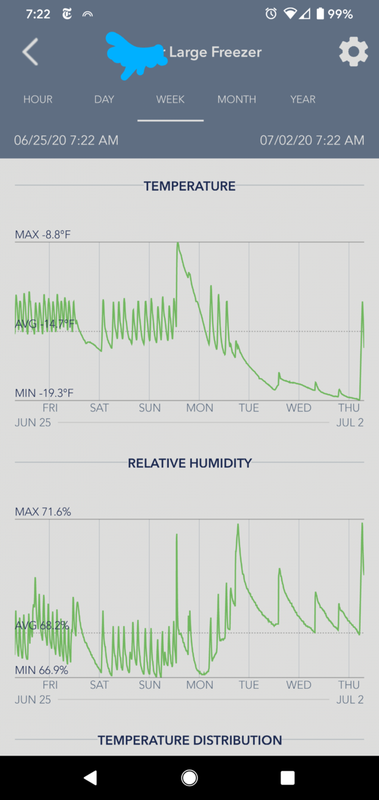

I have been doing this for about a year with a product called SensorPush.
It uses little Bluetooth sensors that are about an inch and a half square. The battery lasts for a year and is replaceable. It collects data at one minute intervals, and the sensor can also store about two weeks of data, so you don't have to worry about missing data if you aren't around. There's a pretty solid app for viewing the data. It runs in the background on your phone and pulls new data from the sensor whenever a sensor is in range of your phone.
You can use just the sensors standalone and rely on your phone, but if you prefer WiFi, SensorPush makes a WiFi gateway. It's a little box that you plug into the wall, it talks to the sensors over Bluetooth and sends the data over your WiFi and the internet.
The app also lets you set alerts for if temps go outside ranges you specify.
I've been using two WiFi gateways, one at my house and one at my mother's, and four or five of the sensors for about a year.
They aren't specific to freezer use - they cover a wide temperature range. I'm using one to monitor a malfunctioning AC thermostat right now, in addition to the freezers.
I have been very pleased with the system. It is available on Amazon. The WiFi gateway is $100 and the sensors are $50 each.
These are screenshots I took this morning of the overview page of the app and the graph of the sensor data for one sensor.
