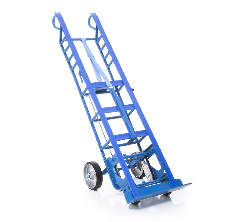

Hire a professional. It’s well worth the money.
When I lived in Washington, the Distribution Center I managed had a service team for installing coolers and other equipment you would find in a convenience store. I wanted one guy to be able to safely move a fridge, or open air cooler. Being that those are only 400 lbs or so, this was overkill, but it kept the team safe.
Rated for 1600 lbs, and has 4 wheels to it sits back and you don’t have to balance it. These things are pretty awesome. I know it certainly made the work a lot easier.
https://dutro.com/product/1888...nding-machine-truck/

Big Grin Eek Great Day in the Morning ! That thing is a monster ! Big Grin . The one that I used also has a second set of wheels , it made hopping refrigerators up and over thresholds a dream . I wonder if it is half again as much as the Harper ? ( I thought I'd seen everything )
