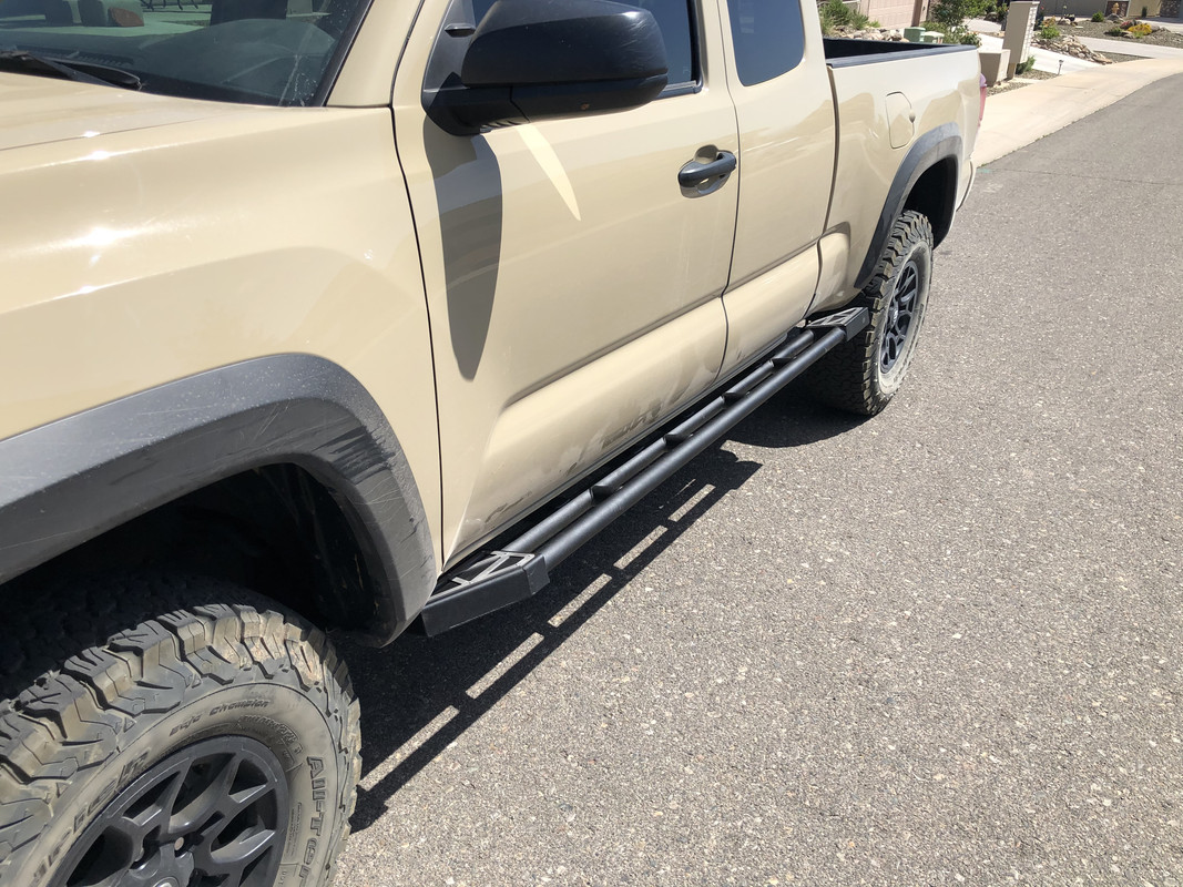

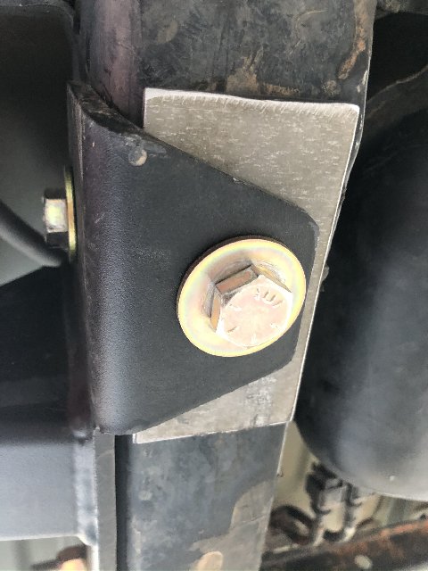

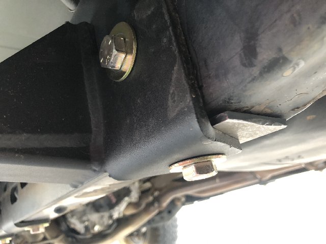

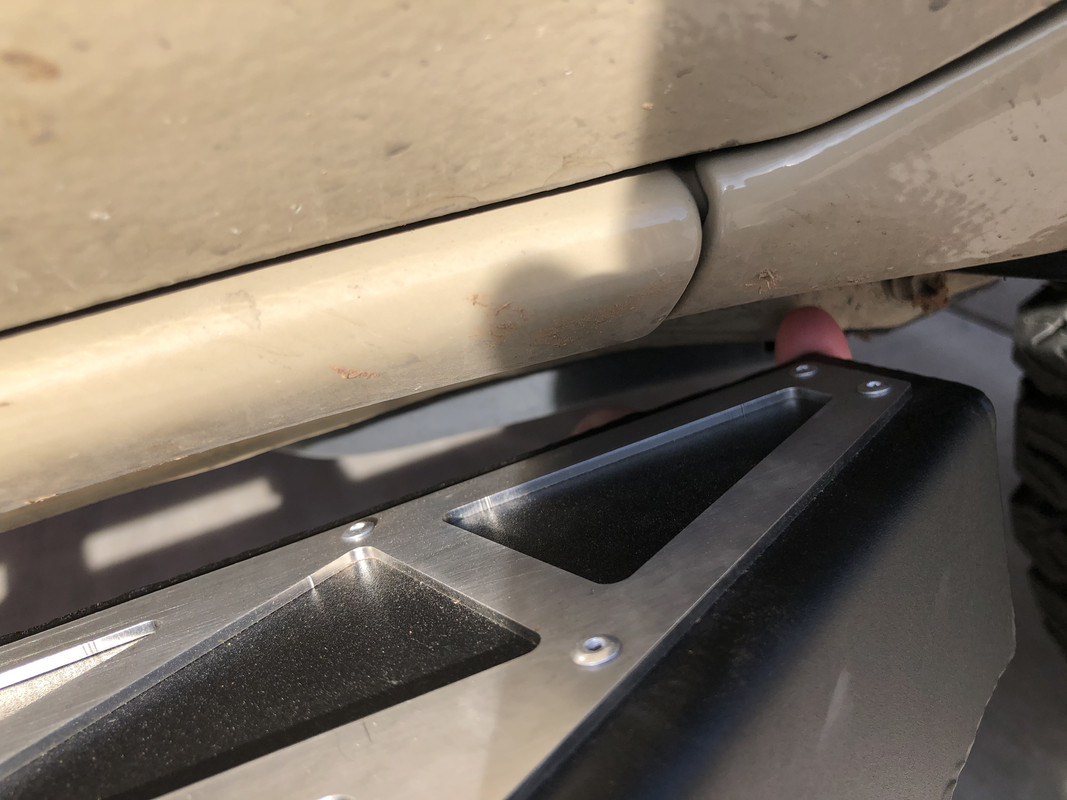

Installation starts. Passenger side, all went pretty well, with one big exception. The 14m both that they give you a replacement for, the tabs are not correct. Either take the sliders off and re-drill the damned hole, or drill out the factory welded on nut and drop a 1/2” bolt in there. Same on the driver’s side.
The instructions are incomplete as you need to fab a makeshift tool to get shit in the boxed end of the frame, unless your wife is cool and has tiny hands.

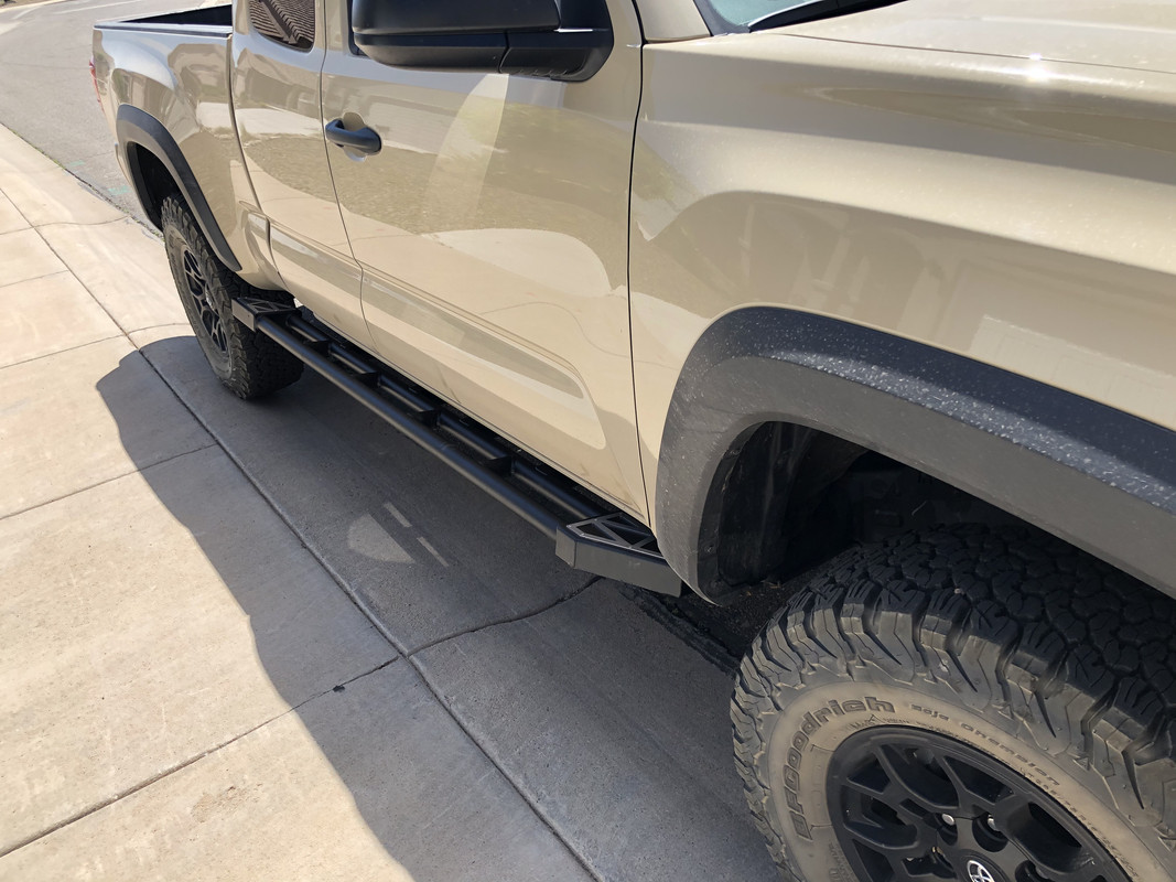

Finally installed. Stoked as fuck. They look great. Then we went for a drive....

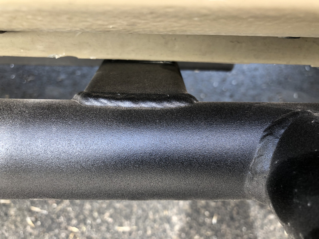

One thing to note here, is the sliders have forward and backward adjustability, but it’s about 3/8” at best. There is zero adjustment side to side. That said, because of how the brake lines are situated on the inside of the frame, there is probably less than 1/8” adjustment on the driver’s side. You get the full 3/8” on the passenger’s side, but I would prefer them to look symmetrical.
So driving around town on the less than stellar roads, the bars hit the cab when there is cab/frame flex. There is literally a finger of space between the bars and cab. Doesn’t change if you rack them as far back as possible. Still beats on the cab over bumps. They sit three fingers off the real quarter panel on the passenger side and two off on the drivers side. Back to the fronts, less than 1/2” from the cab.
I’m not trying to trash Demello. I have wanted their sliders since I had an FJ. Best looking sliders available. I wanted these to be better than I had imagined. Not a fucking chance. I bought a lemon and it is what it is.
Too bad they fit like they were made in China. They still look cool as fuck. I think I’ll be creating a dent in the cab/pinch weld so the front of the bars can clear without making a ruckus when going down the road.
I wouldn’t buy them again, no matter how cool they look. Hopefully they send me two more bolts so I can secure the fronts, since the 14m bolts were worthless.
First pic, that’s my pinky finger. Couldn’t put my index finger there. Gap is too tight. If the bars racked all the way back, the brake lines would have prevented some of the bolts. That’s how close the 3/8” is.

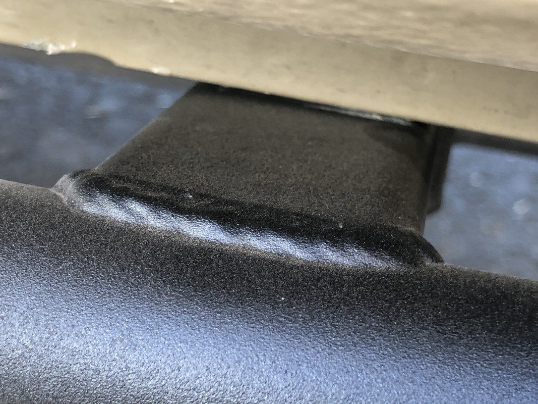

I will be contacting first thing this morning. They’re closed over the weekend. I hope there is a good outcome to all of this, and Demello makes it right. I also found whee the loud banging is coming from. At first I thought it was the front corners. Then after a short drive down a bumpy road, I was able to find this. It looks like one of the four support tubes was just a hair off when it was welded in place.

I sent pics and had a phone conversation. He agreed that the mounting brackets were incorrect, and that one of the sliders was welded wrong.
He offered a full replacement on his dime. Offered to expedite them through production, powder coat and shipping. I would have had them by the end of the week.
Now if the mounting brackets are incorrectly bent, and the holes are off a little, and you send me correct ones, I’m either wallowing out the brackets, or redrilling the holes in my frame. Not interested in either option.
So we both agreed that while the brackets were off a little, they worked just fine. The one slider that was welded incorrectly is not as simple.
While I appreciate that he was willing to stand behind his product and offered a full replacement, I didn’t feel that was necessary. We came to an amicable agreement. I didn’t see the need to take advantage of someone when a mistake was made, and it is a fixable situation.
I loosened up the drivers side slider, and on the last tab where the bar rode the cab, I cut a 3”x4” piece of 3/16” steel. Drilled it and used it to space the slider away from the bottom of the frame. No more rubbing or noise.
