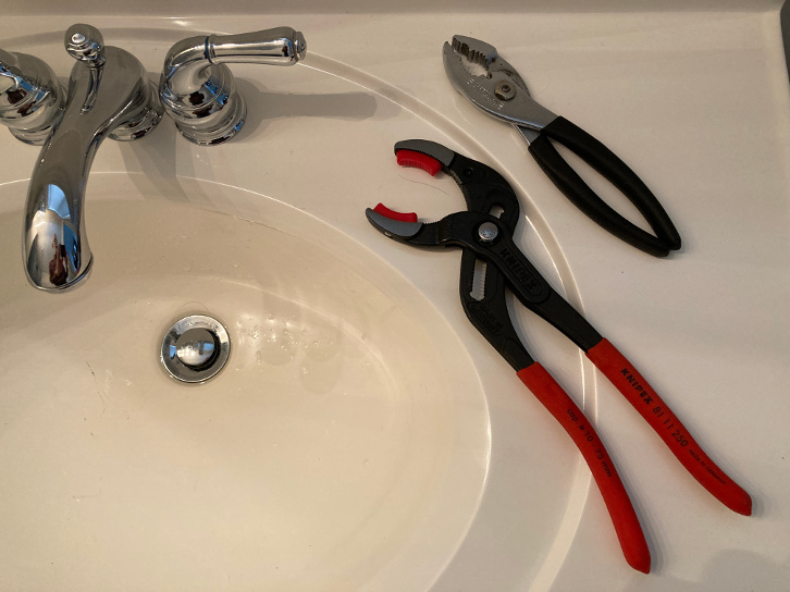

Update: Success!
It was indeed the cartridge.
All I needed was my hands and the two tools shown below:
Those Knipex 81 11 250 "Pipe and Connector Pliers with Soft Jaws" were just what the handyman ordered Smile
I saw somebody mention those somewhere here on SF, thought "How many times could I have used those?", knew the need would arise again, and bought a pair.
Those pliers are spendy, but there was no way I was getting that thing apart with my bare hands. Then again: My smaller strap wrench probably would've worked, too.
Thanks, again, everybody, for your help!
