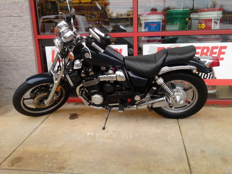

Nice, I love the 80's Japanese bikes
My 85 MaximX I restored a few years ago, this thing was a screamer with a seemingly infinite RPM
I have given up bikes after a soccer Mom pulled out in front of me, sending me flying like Superman

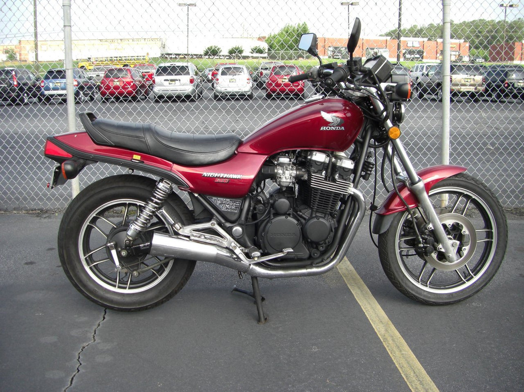

If I can find a pic, I did a resto on a 85 Nighthawk 650 too
Posts: 7012 | Location: GA | Registered: September 23, 2009Reply With QuoteReport This Post

Found them
This was my first bike after not having one for about 20 years

Grandson had the 750 Nighthawk as his first street bike.
Posts: 16710 | Location: Downeast Maine | Registered: March 10, 2010Reply With QuoteReport This Post
