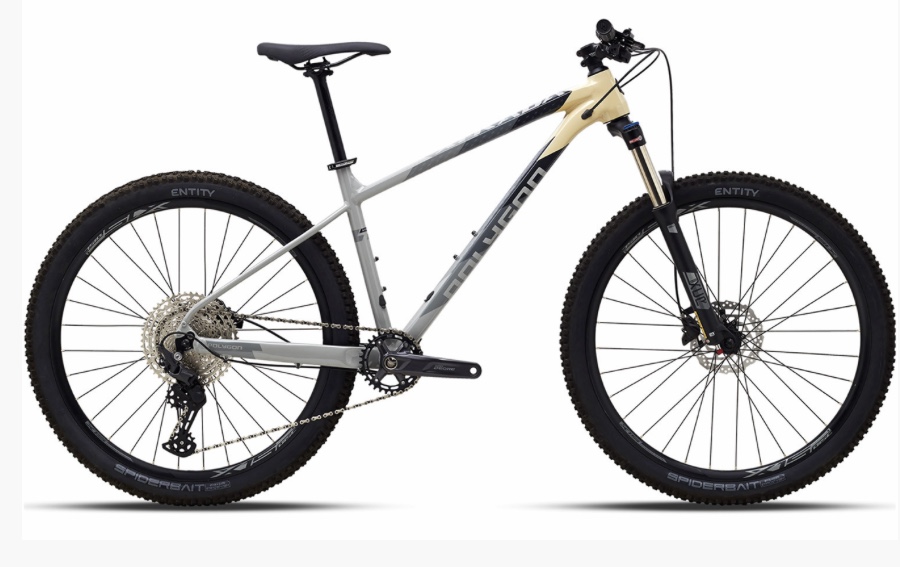

Does anyone here have any experience with Polygon bikes? They seem to be a decent entry level option for the money. I’m considering using a 2021 Polygon Xtrada 6 1x11 hardtail as the base for my winter project/ first e-bike build. I’ve been doing a lot of research and it doesn’t look like a terribly complex project.
Why? It is a good looking bike that has decent components and a lifetime frame guarantee. The seat stays are kinda thin but the chain stays are nice and meaty. I thought about using my old steel frame Schwinn mountain bike but it’s brakes are terrible.

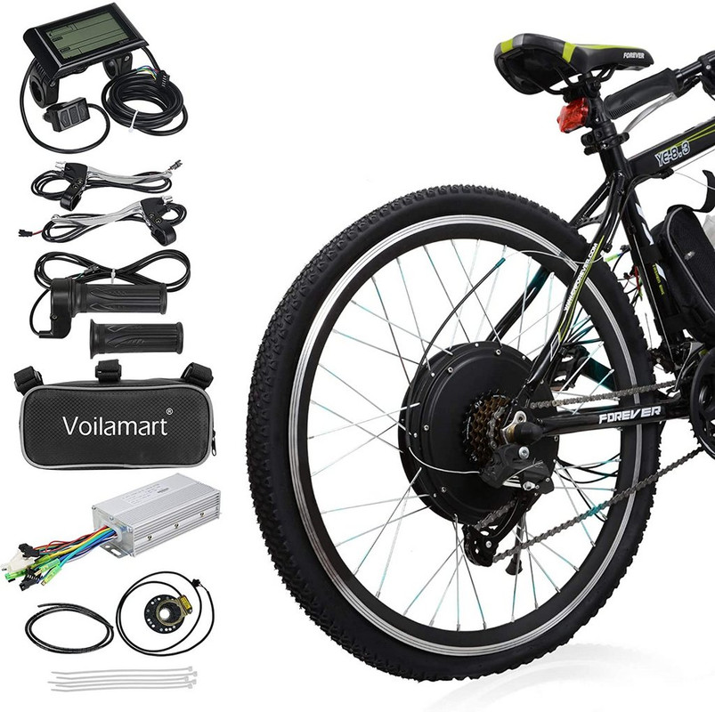

Im about to order a kit similar to this but with an upgraded rim. I’m leaning towards a rear wheel drive 48V 1500W kit.

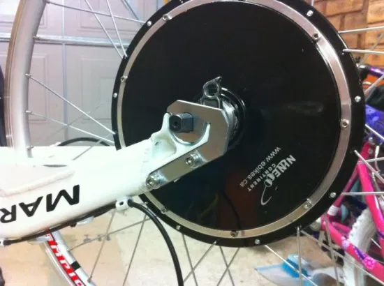

It will definitely need a torque arm installed to help spread the stress from the electric motor. Something similar to this.
That frame is T6 and the chain stays are pretty thick so it should be ok with a good torque arm....hopefully. I’ve seen similar builds that use aluminum hard tail Trek bikes. I really want to avoid a steel frame bike if possible.
I’m not trying to build some high speed machine but rather a bike with enough grunt that it can handle hills and light trail riding.

I went ahead and pulled the trigger on the Polygon Xtrada 6 1x11. Here we go. Big Grin

I thought the warranty on the Polygon frames was only 5 or 10 years. No matter - if you modify it you’re going to void the warranty. Polygon alloy frames are just as good as 95% of the other frames out there. They just make their frames in Indonesia, rather than sourcing frames from China or Taiwan like all of the major U.S. bike brands. Polygon is a direct-to-consumer business. You won’t find a better price/deal on similarly specced bikes. You’re trading support of a local bike shop and customer service for that lower price.
The brakes and Deore drivetrain are fine (for a non-electric bike, anyway). For your project, I would want to up those rotors to 180 or 203mm for a little more stopping power.
Kinda looks like the coaster brake I had on my first bike a good long time ago. Razz
