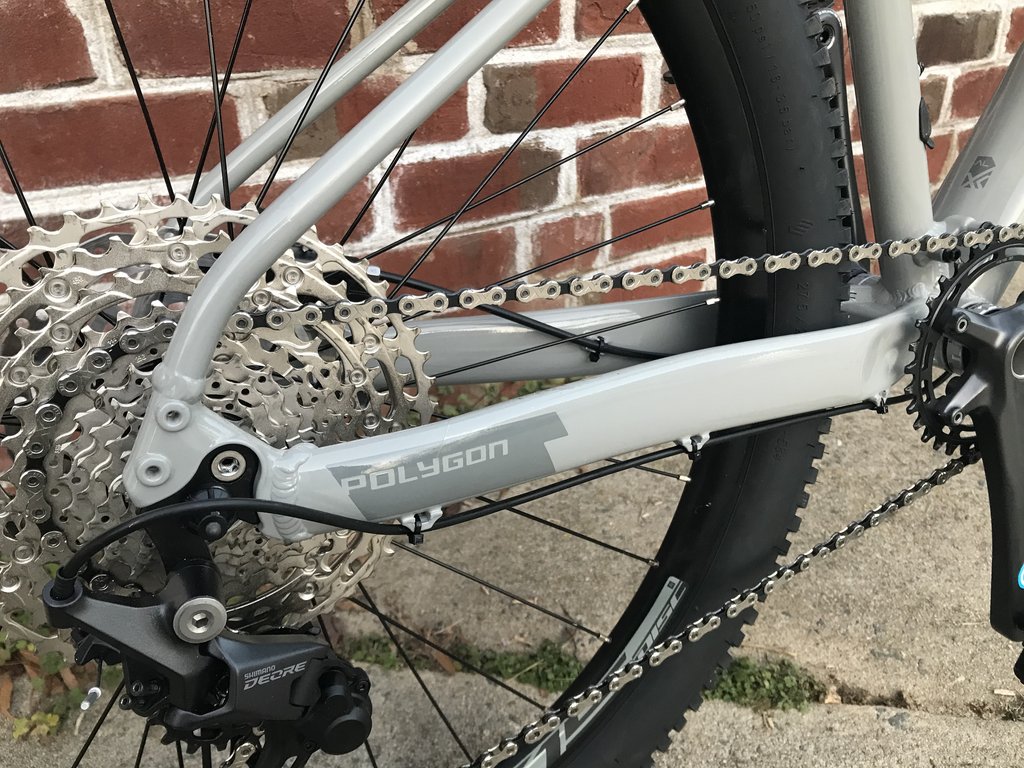

This bike has been a pleasant surprise. Assembly was beyond simple. The derailleur was difficult to tune and I couldn’t get it perfect so I took it to my local bike shop. I felt better about my mechanic abilities when I learned today that they struggled a bit to fine tune the bike as well. After liberally oiling the chain and fiddling with the derailleur for two days they finally got it pretty much perfect. When I asked the guy how they got it dialed in and fixed the dude let out a long sigh and began to explain how frustrating the process was. Big Grin
Coming from a BMX background I cannot bring myself to adjust to these wide as hell handle bars. They just don’t feel right. Wide bars seem to be all the rage right now but I’m tempted to cut these bars down to around 25.5-27 inches so it feels closer to my Specialized Stumpjumper, which has absolutely amazing ergonomics.
My new two wheel machine is a blast. We just need some warmer weather and a bit less rain so I can thrash the hell out of it on the trails.
Look at those beefy chain stays! This is a solid & well built bike!

That's a nice looking bike! I'm glad the brakes bedded in and improved.
If, after a while, you decide you need more braking power, it is easy to put bigger rotors on - you just put on the bigger rotors and add standard-size spacers between the calipers and mounts.
I wonder if the derailleur hanger (the little plate that bolts to the frame and that the derailleur bolts to) was a bit bent.
The couple of Shimano 1x drivetrains I have installed and set up have been pretty much set the limit screws, set the B-tension so the line on the derailleur lines up with the edge of the largest cog, turn the shifter barrel adjuster until nothing clicks, and you're done.
With that said, modern 1x drivetrains have the cogs so close together that the misalignment from even a very slightly tweaked (so slightly you can't tell looking at it) derailleur hanger can cause problems.
It's enough of an issue that there are special tools for checking hanger alignment and tweaking them back straight.
