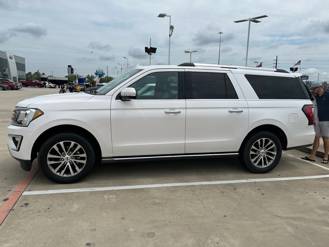

Sitting in the driveway, financing to run through my CU tomorrow
2018 Expedition Max Limited. Pearl/metallic white on taupe (grayish tan) leather, bucket seats in 2nd row.
Definitely doesn't drive like it's as big as it is.
Massive next to the Flex.

Digging it!
Glad you were able to get something worked out. I know it was not your first choice but having owned both I wish we still had the Expedition and not the Suburban.
