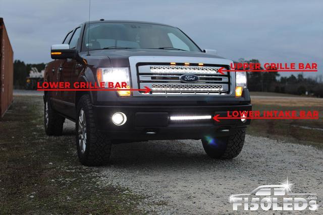

I would mount the light bar between your fog lights.
My front license place bracket covers that spot on the bumber. We don't have front plates in Michigan but I have a Fire/EMS plate in mine.

I settled on Digital Diode lights, but there are several brands out there that are similar. Above comments match my experience.
You Tube has a plethora of good information. Unless you mount two sets of lights, driving/spot and fog, I would go with a Combo light.
There are several switch panels out there that combine the functions oh multiple switches. Very handy but pricy a with a lot of wiring.
Like the Ford above, mine are mounted in grill openings, very subtle. Of course there are many options if you have a grill guard.
