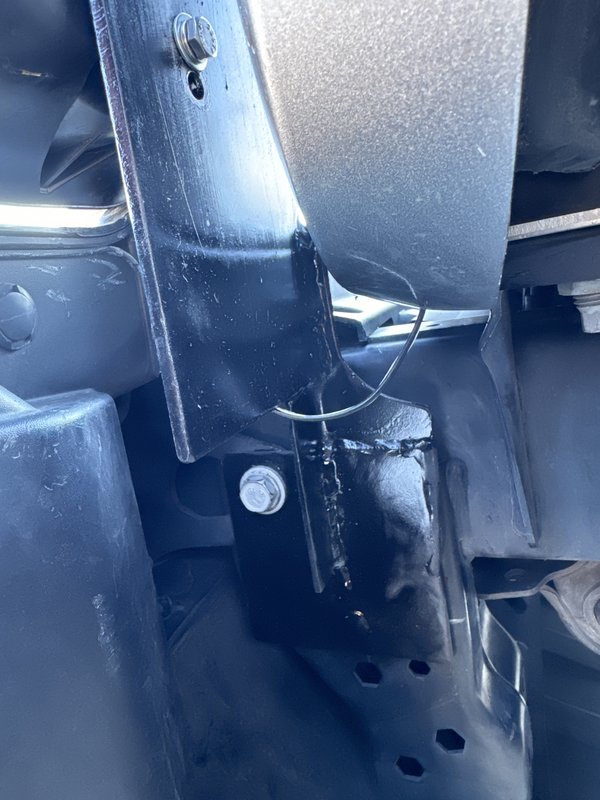

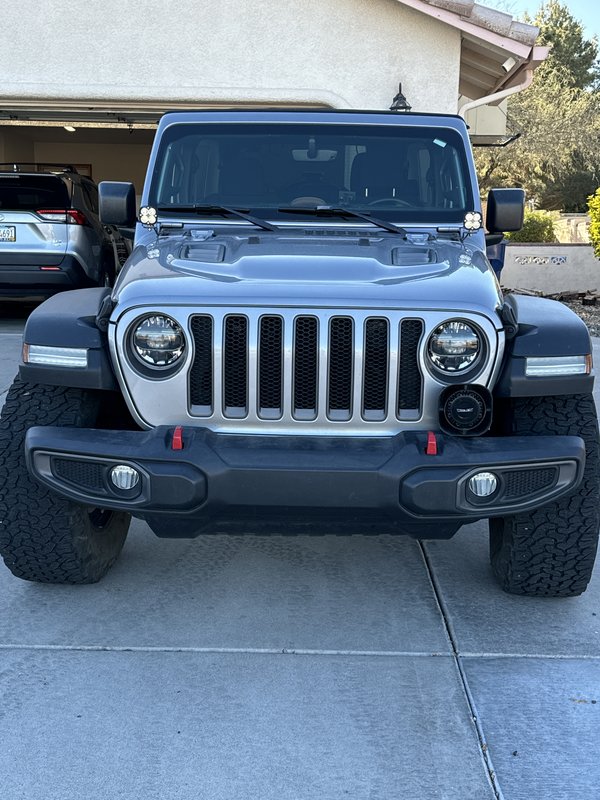

So it sat on the shelf for almost three years as I couldn’t find a place I would mount it. I finally was fed up with the left lane shitbricks, and built a bracket to hold it in place under the headlight. I really dislike the location, and I’m not a fan of the look, but there is nowhere to mount that thing where it would be concealed and able to be heard. I wanted it behind the grill, but there isn’t enough depth between the grill and the many different cooling radiators, as the speaker and bracket would be too much.
Side note, did you know that six plastic rivet clips (push pin clips) hold the grill in place? Take those six out and there are a handful of push in pieces and that’s it. Literally a five minute job.
So back to the bracket, I measured a dozen times and it came out correct. There was no where I could easily bolt a plate with two bolts. There was one bolt that secures the bumper bracket to the frame. Plenty of pre-drilled holes, but no way to get a nut on the back. I ended up welding a stud to the plate that goes in a hole like a bolt, but never tightens. This gives it the shear support and the bolt that attaches the bumper bracket sandwiches it tight to the frame. I hope this description makes sense. I should have taken a few pics before I mounted it. It’s actually pretty cool, over engineered, but quite okay.
Anyways, here are a couple pics and a video or two…

WRT mounting where there are "plenty of pre-drilled holes, but no way to get a nut on the back." You might want to investigate "rivet nuts" - like pop rivets, but the crimped part is threaded for a bolt.
