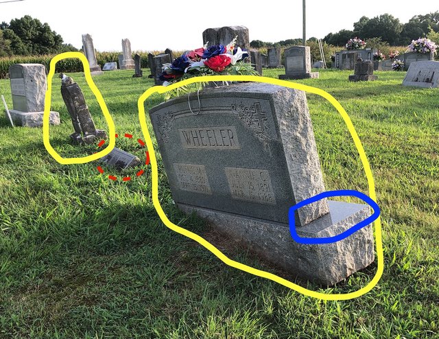

Wife's family has a couple family grave sites where the marker stones have sunk and need to be re-set.
I don't think the cemetery will allow me and a couple redneck buddies with chains, come-a-longs, an old pickup or two and a couple bags of Quikrete to work on them. Big Grin
So I told the wife we might spring for a gravestone company to pull and reset them... BUT before I expend any time or effort contacting and getting bids or committing to getting this done I thought I might ask the collective if anyone could advise a wild guess as to the cost.
Two stones. One larger newer one and one old one, circled in yellow. Note the vertical stone is starting to slide off the base. Circled in blue.
The small stone in between, circled in red, was made like that and is not sinking.
The larger, newer stone seems to have a concrete base under it that is still fitted to but angled, sunken, just like the actual stone.
The family is 6 siblings, but half of those would not be in condition to contribute funds toward this and I don't won't to ask the others and make some feel obligated to help. I can certainly afford to do it alone, just wondered if I need to prepare for sticker shock.

A few years ago a couple of monuments in the family plot started sinking. I called the shop that did the maintenance and asked about resetting. What I remember was about lifting the stone, then laying a bed of granite chips and resettling. Cost was a couple of hundred. (The city has granite quarries so there’s plenty of stone)

The tops are connected to the base by either rebar rods or stone pegs and then sealed with caulking. Sometimes they are glued and it’s almost impossible to separate them.
This is a job for a pro.
Contact the cemetery and ask for any companies they suggest. This notifies them and will get you someone local.

I worked for a cemetery for about 7 summers through high school and college. Main responsibility was headstone leveling. The markers we adjusted or installed were much smaller but it was the cemeteries responsibility to address any concerns from family members. We would get work orders daily/weekly to make updates to markers, grass or flower vases. A spud bar and some Till would go a long way to get things leveled out. As otheres mentioned, start with the cemetery "office" and go from there.

If you decide to do it yourself , AND you get permission from the Cemetery ( doubtful ) , be extremely careful when prying and jacking on the base . If anything goes wrong , it will be expensive . That big double headstone in the picture has some serious weight to it .

While I have no experience with tombstone resetting, I have built several stone/concrete block retaining walls. The key is always a good foundation. The hardest part will be moving the heavy tombstone. Once that's done you can excavate about 1 foot, compact the soil, and then put crushed limestone in the hole to a depth of 8-10 inches or so. A hand compactor should be enough to compact before leveling (from all sides) and replacing the stone.
