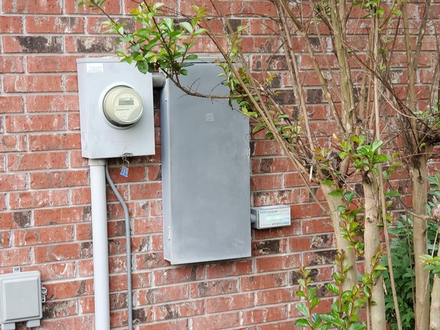

We have this one.
Posts: 8544 | Location: Arkansas  | Registered: November 06, 2010Reply With QuoteReport This Post

The one I posted (pix above) is the FS140. It cost me $100 to have in installed the same day I got it delivered. Installation took about 15 minutes.
