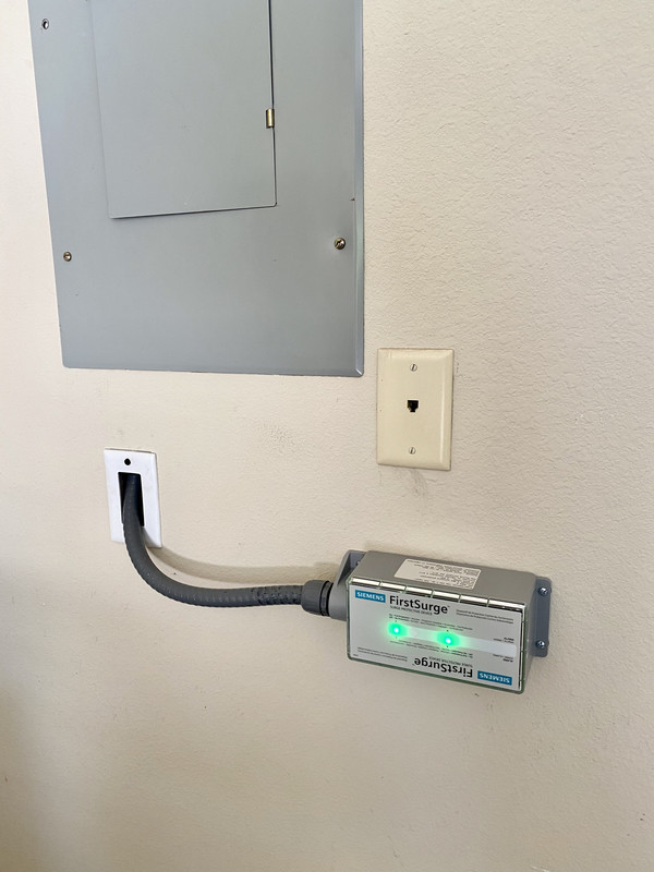

Companies like Square D have surgebreakers, they simply plug onto the buss like a normal breaker and then you connect the white wire.
Picture of PowerSurge
With a surge breaker you’ve only got 20-50,000A surge protection. With the Siemens FS140 you have 140,000A surge protection.

Just following up on this thread for anyone interested. The Siemens surge protector was close to $200 with tax, the electrician charged me $325 to install it..including a couple of small parts I needed. I’m sure I overpaid for the installation, he was here for maybe an hour. They are a very reputable company though and I had to pay a service call fee to get them out so there was no point in canceling at that point. I’m glad it’s done at any rate.

I'm used to installing lightning protection in High Voltage Substations . Explain how they can rate this thing for 140ka while being wired with what I'm going to assume is #12 wire and a 20 amp breaker . Also , what is the clamping voltage of this unit ?
