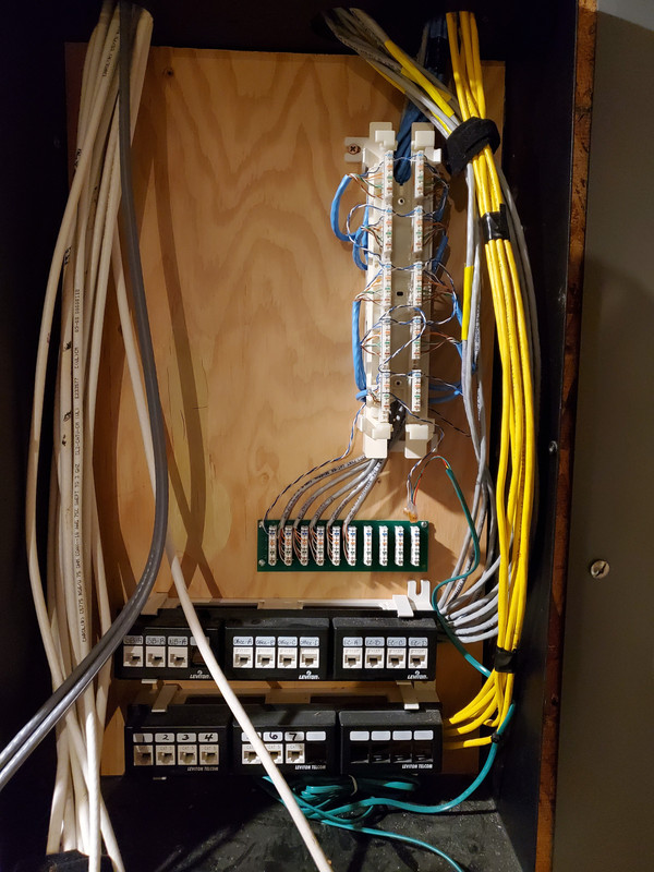

We moved into a new home about a month ago. The previous owner had the house all wired for ethernet and cable, but I don't know much about this stuff. Can someone take a look at what I have, and maybe explain what it is and how I would get a network signal to all of the ethernet ports in my house? I'm a software engineer, so I'm not a complete idiot about this stuff, but it's never really been my thing.
We have wifi, but it's a big house, and the signal isn't that great. If we could get all our ethernet ports wired up, that would solve a lot of problems.

Connect from your router or switch ethernet ports to the ports you see on the board. They should be numbered to match the ports in each room.

I am missing a switch and a modem/router in this pic.

The wiring up top is telephony. (blue and grey wires)
It could be re-terminated using similar 12 port patch panels as are on the bottom if needed.
If the two patch panels (yellow and grey wires) on the bottom are home run from this demarq to each jack in the room's wall plate, then as stated above, get a switch with enough ports to attach patch cable from each port on the switch to each port on the patch panel, then connect a/the lan port on the cable modem (if it is a router type, most are nowadays) to the switch.
If it is just a cable modem with "ethernet handoff", then you can connect your router WAN port to the cable modem, and then the router LAN port to the switch.
That will make all of them available.

Personally, I'd tear out those two patch panels, install CAT(5 or 6) plugs on the wires and plug all of them into a 24 port Netgear switch. Then follow the monkey's instructions on attaching the switch to a router and router to a modem and you'll be good to go.

That looks like what i call a patch panel.
You need to run a router off your cable or other broadbank modem. You run that into a switch. The switch can have 5 to 32 (or higher number of) ports.
Once you have those, you run a cable from the other ports on the switch to each of those inputs.
That will make all the ports in your walls of each room live to connect things to the internet.

If the OP can't ID a patch panel, I'm not sure he'd want to take up the task of crimping ETH plugs. There is no need, no benefit & a whole lot of possible headaches. I've crimped 100s & I'll still take a punch-down or tool-less keystone over crimping a plug.
That setup looks like it was done with care- just grab some short ethernet cables, and a switch with enough ports to plug it what you need. 24 would cover your entire panel, but if you want to save some cash, 8 or 12 would probably be enough.

I agree with comment on leaving the patch panel. A better recommendation could be made if pictures were posted showing router/modem and wiring around it.
Posts: 943 | Registered: June 16, 2012Reply With QuoteReport This Post
The bottom two rows are your network cables to rooms - the top section is telephone.
You can simply mount a switch on that panel and connect the rooms you want to have connectivity. That means a bunch of short cable from those bottom two rows to the switch. There are several ways to set it up based on where your router/cable modem is located.
service line –> modem –> router –> switch –> patch panel –> client devices

Thanks everyone for the input. It's beginning to make sense.
So, would this worK:
I split the incoming internet signal (coax) in two:
Downstairs in utility room : cable > cable modem > switch > patch panel > client devices.
Upstairs (where I want to move my wireless router) : 2nd split cable > cable modem > wireless router
If I connect a printer to a wired ethernet port in the office, would devices connected to wifi be able to 'see' that printer?

Not sure you can split you internet coax and use two cable modems.
If I were you I would run my internet to that closet and put your cable modem and router there. Connect the ethernet ports from your patch panel to your switch and connect your switch to the cable modem. Upstairs I would plug an wifi access point into your ethernet port upstairs.
Regarding your printer, yes. If your printer is on the hardwired ethernet your wifi devices will be able to see it.

Yes. You can split and run more than one cable modem, but you will have to pay for the service for each modem.
Better the run a line from one switch, to another switch, that ties the two together and extends the network.
(Is there a patch panel/closet both up and downstairs?)
If the wired and wireless networks are on the same subnet, or bridged networks, you will be able to see the printer.

Also if your home is large and this wiring closet is not near the wireless "listening" area you may want to turn off the WiFi at this and add an AP at the end of one of those RJ45 connections in a room more appropriate.
You do not have to turn it off but if you add an AP you would want to configure it with the same protocols of the main one.

If you're dead-set on having the wireless router upstairs away from the utility closet, put the cable modem and wireless router upstairs where you want it. Then plug an Ethernet cable between the router and the wall plug that's coming from the patch panel. Then in the utility room plug another Ethernet cable in the patch panel coming from the room where your router is at and plug it into a switch. Then connect the switch to all the other patch panel ports.
You're probably right given the circumstances.
I wouldn't go so far as to say there's 'no' benefit. Doing it as I suggested results in a simpler, cleaner, install, with half the number of ethernet cables (and I hate all those little short cables).
I too have crimped my share of cables, but I still don't mind doing it. I think I truly am an exception to rule though. Smile
Picture of cne32507
The bottom row of Ethernet receptacles at the very bottom are already numbered, 1-7, with 7 yellow wires leading to 7 marked Ethernet outlets in the rooms. The row just above that looks like telephone jacks with gray wires leading out to (room) telephone jacks. Just get some hardware stuff (modem, router, 7+ short cables) and screw them to the plywood. But I dunno shit about this stuff.
As I said earlier. What does he currently have for WiFi? Where is it located? Is it close to a patch panel? I asked it he could post a picture.
I think it would be best to assess what is in place and then plan the best solution.
