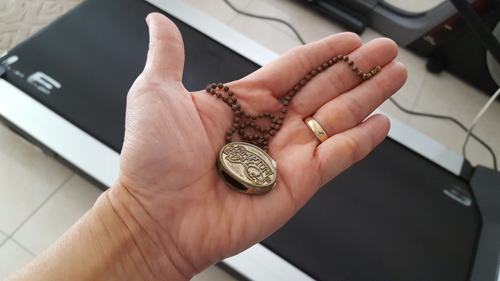

I've been zapped countless of times by static electricity, and I'm sure most, if not all of you, have also. Always a no big deal. Until...
Yesterday morning, I was going to go running out in the street but then heard a lot of thunder rumbling. So, I went and checked the weather radar and saw a heavy storm about to roll through our area. Not wanting to potentially get struck by lightning, I decided to run indoor on my treadmill...
And I was running on the treadmill like I've done a gazillion times. Ceiling fan on high. Ran for an hour. When finished, I reached up to grab the pull chain to slow the fan to medium, already expecting a microsecond zap and done. Instead, my hand just got sucked in and stuck to the chain and shocked for, and I estimated, about three seconds, before I came to the realization and yanked hard and broke the chain. All that brief of a time, I was feeling the shock coursing through my body to my arm. That was truly a Holy Shit moment. My fingertips were sore and numb the rest of the day, but I was fine otherwise. But I still don't get it. The same activity that I've done time and time again, and all of a sudden, shit happened. Reminded me of Death Wish II's end scene, when the bad guy was electrocuted. That's how I felt, but luckily I'm still here.
The next time, thunder or not, I'm going outside. Big Grin

Except for the broken fan pull chain, nothing is apparently loose. Fan stills works but is now stuck at medium speed. All four light bulbs are functional. No further shock since yesterday. Yeah, I'll eventually have some pro take a look at it and see.

I agree with everyone else, that doesn’t sound like static. Definitely some difference in potential going on there. From your picture, a question. Were you standing on that treadmill? If so, have it checked by a pro. You spent an hour spinning that belt and working it. Possibly a source?
