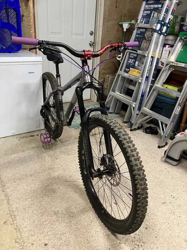

I bought a Chromag stem in 35mm rather than the 31.8 that you often find on mountain bikes. I got it because it was a smoking good price but then later discovered what I thought was the length of the stem was actually the bar diameter.
Is there much benefit to running a 35mm diameter stem/handle bar?
I’m gonna give it a try along with a deity 50mm rise set of bars on my do anything Chromag Sylus. It should make it feel a bit more like the old BMX bars I used to love but I am wonder about what trade offs there will be with the higher, stiffer bars.

I put one of the OneUp bars on my bike partially because why not and partially because the stem I wanted in the length and rise I wanted I could only find in 35mm.
I went ahead and swapped out the stem and bars and so far I like it. The lower bars definitely made cornering more confidence inspiring but hitting a few jumps in the front yard with the new bars and stem felt good.
