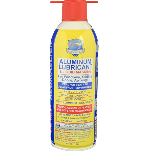

Ace Hardware (and probably other hardware stores) has a can of lubricant that is marked specifically for patio doors. Clean the schmutz out of the tracks before you lubricate it.
