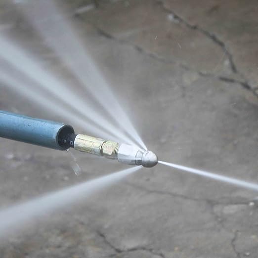

I have a number of downspouts that empty into plastic pipe that runs underground to who knows where. A couple of them are nowhere near street, other drainage etc. I am pretty sure a couple of them are clogged due to general neglect of gutter cleaning by prior owner.
How best to clean these out? I'm assuming any sort of mechanical auger device risks damaging the plastic drain pipe. Do the water jet type cleaners work? If so, any recommendations for one?
I have decent but not extreme water pressure at bibs. Do have an Sun Joe 2030psi pressure washer I could incorporate into this if helpful.
These things gimmick or useful?
Pressure Washer Sewer Drain Hose

I have a similar issue, but I know where mine exit. I clean them out every few years using Nelson twist nozzle and going in from each end. Can you figure out where they exit? Leave a garden hose in it and see where the water exits?
https://www.homedepot.com/p/NE...zle-VG2284/202532096

    I have the same problem. Doing some research. This link has a chart listing the nozzle size needed based on the pressure and gallons per min of the pressure washer
    http://www.ultimatewasher.com/...-pressure-washer.htm

    The city has stuff like this to clean sewers. A commercial plumbing company has similar equipment that would work and not damage the line. Make some calls unless you like doing this stuff yourself.
