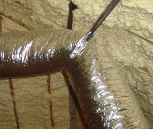

As the OP is indicating that there's inadequate flow from just one ceiling vent, it's almost certainly not an issue withe the Evaporator Coil being restricted, unless he's got decreased flow everywhere. It's much more likely that the duct feeding that particular vent is restricted in some way. Often times, ceiling vents (presumably in an attic space) are fed using flex (flexible duct...think dryer vent but bigger and insulated). Depending on how it's run it can easily be kinked/restricted and result in low flow. The OP should check that first. It's also possible that the design (and installation!) of the ductwork simply results in marginal flow to that particular vent, which 'could' require throttling other vents to increase the flow. An important question here is whether this particular vent has always had low flow, or has something changed to cause the issue, which would be valuable info to determine the likely cause and/or solution.

In my last house, the farthest room has low airflow as well. Come to find out that there was a tear in the flexible ducting in the attic leading to that room, so a good portion of the airflow to that room was venting into the attic space instead.

Flexible duct is notorious for improper installation when using 1-2" strapping cloth as hangers.
Even when done correctly, overtime the duct sags and can be nearly cutoff of airflow.
Check to see if they used saddles to support the duct or other means to prevent collapse.
