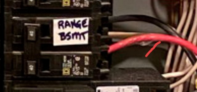

What is going on here?
Posts: 21517 | Location: Loudoun County, Virginia | Registered: December 27, 2014Reply With QuoteReport This Post
thin skin can't win
Picture of Georgeair
I’m unsure what you are asking. It’s for the second kitchen range.
