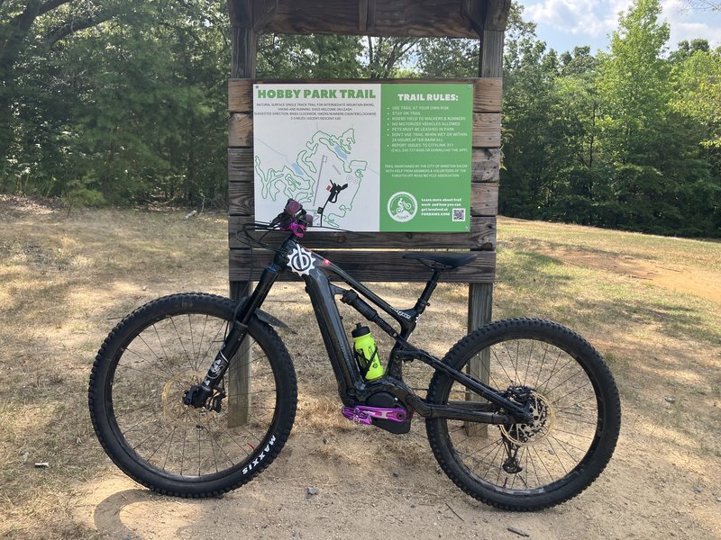

Trek is the competition to the shop where I work and the brands we support. Truth be told, I’ve gravitated towards class 1 full squish ebike racing lately. My regular mountain bike collection has been mostly sold off to co workers to fund racing. I only have two full suspension mountain bikes currently AND my hardtail collection has been hit hard too…..this new hobby is VERY expensive.
Once you ride something like this and get a taste for racing in the electric class you lose all interest in traditional (slow) MTB. The only stock parts on this Cannondale Moterra Carbon class 1 e-bike are the frame, rear triangle, rear shock and seat post clamp. Eek
