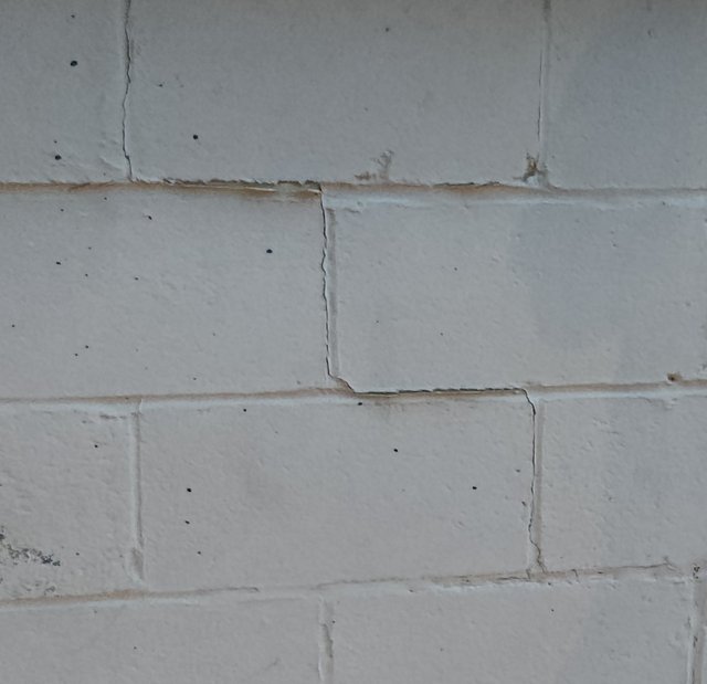

Should I use mortar or the caulk style stuff to fix this?

Do you want to do it the easy way, or do it the right way?
The easy way to do it is to patch it with some masonry caulking. This doesn't do much for the structural integrity, and it can sometimes be hard to match the color, thus making the repaired area stand out cosmetically.
The right way to do it, to both make it look better and repair its structural integrity, is to scrape/chisel/grind out the outer inch or so of the cracked mortar areas and reapply mortar to these joints. This is called tuck-pointing or repointing.
And if you haven't already, you'll want to try to determine why it cracked. Some cracking from settling can be normal, but it can also be the hallmark of a bigger foundation issue.

For some reason I can't zoom in on your pic. What I am looking for is to see if they are just hairline cracks or if the cinder blocks have pulled away from the mortar joint.
As long as you don't have a structural issue, or if there is not water infiltration if your pic is inside your basement, you could get away with caulking.
If structural or if water is a problem, grind out to a depth at least 1" and follow the crack lines joints as a guide. Mix up a batch of mortar, make the grind line wet, and press in the new mortar.
Then you use a joining tool to make the mortar smooth to match the surrounding joints. Use a small sprayer and spray the finished joint a few times a day (the longer you keep the joint moist the "harder" the mortar becomes). Wait a few days and then paint.

Sorry for bad pics. The cracks are small, they look larger from the paint failing on top of the cracking.

That type of cracking is considered normal and routine. I don't see signs for bad settling. Hence you could just scrap off the old paint around the crack, seal with caulk, and repaint.

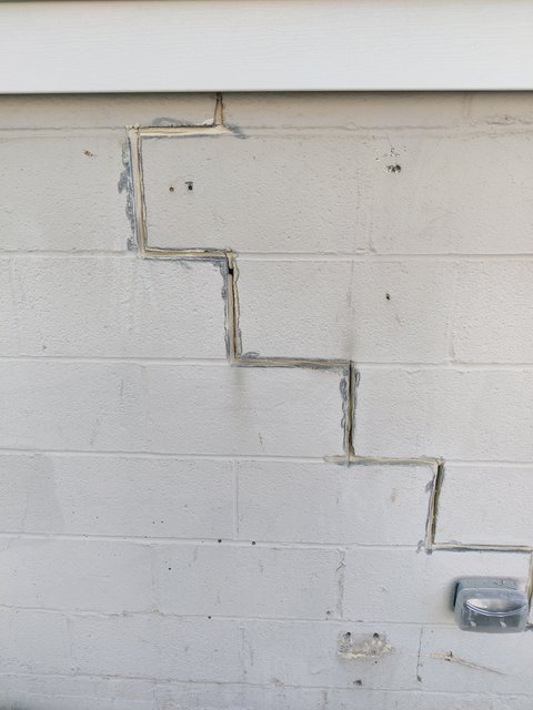

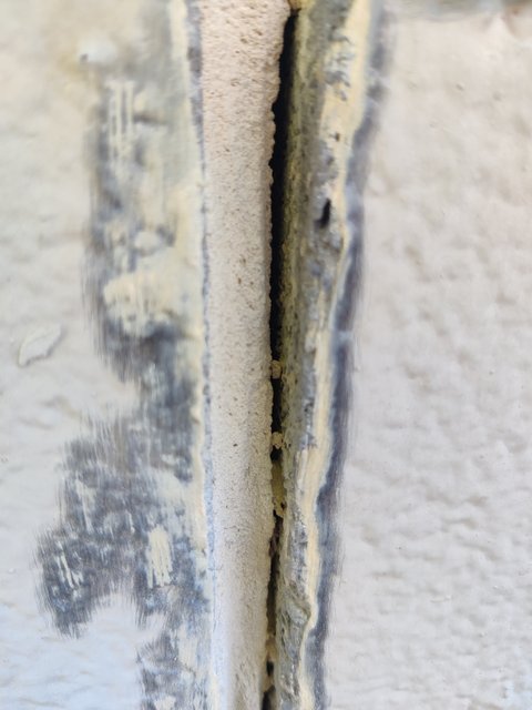

Bought the caulk, don't think it's going to work. Says 3/8" max gap. Some are almost half inch, if not over 1/2".
Here's what I'm looking at cleaned out.

Repointing is not difficult or all that challenging. It's just more effort than squeezing out some caulk. Lots of Youtube videos on how to do it.
The most time-intensive part is chiseling out all the cracked mortar. It can go faster if you have access to an angle grinder with a diamond blade.

Wait, what? Have all of it ground out? I removed all the areas that had any cracks. There would be no benefit to removing mortar everywhere. Just want it to look decent after paint. Given the condition of block currently it will never be perfect. I just want it to look good for 5-10 years.
I have looked at the Sika product you mentioned. For now I am going to buy that or similar so that the contractor can pressure wash to remove the bulk of failed paint/cracks without intrusion through the poor mortar joints. Then will reevaluate how to deal with the rest of the failing paint/cracks.
I really want to if not for cost just parget it and cover the original crappy workmanship.
