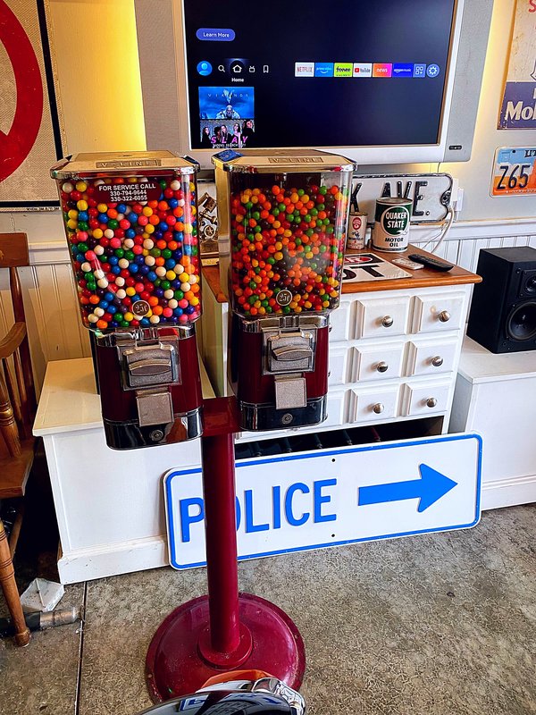

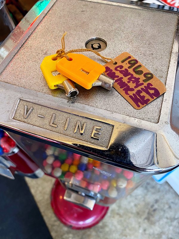

Going to attempt this as well on a couple parts on the 1969 double V-Line candy machine I picked up.
