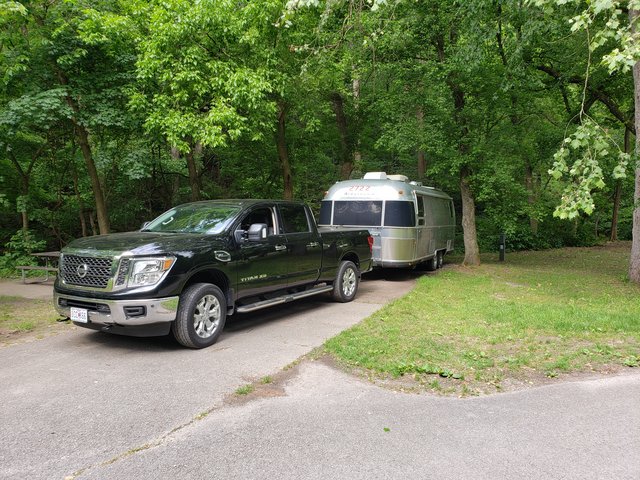

I would stay 25ft or smaller for that size of a truck. Get a good weight distribution hitch. Set it up right and you won't know its there. If you don't set it up right you will be fighting the trailer the whole trip.
This is our setup. 2002 25ft Airstream pulling with a Nissan Titan XD.
