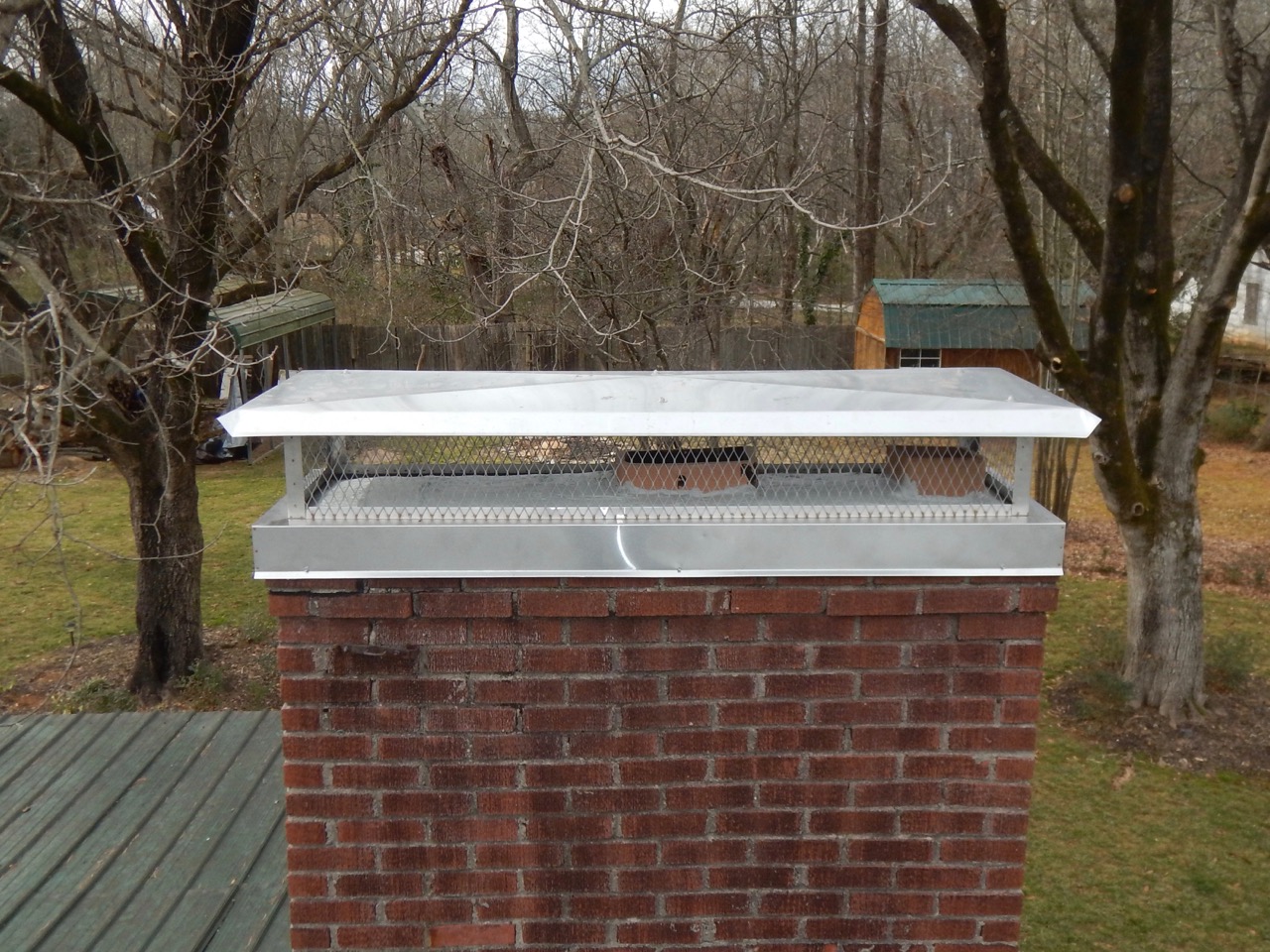

building a fire would not solve the smell problem. the dead critter is laying back on the smoke shelf and would not get hot enough to cook off.
I've over the past 38 years taken so many various dead things out of chimneys it is hard to collect it all...
Why a chimney would not have a proper rain/animal guard is beyond me. I would humbly suggest you get the one the chimney sweep offered and the crown repair they suggest and not what your 'contractor' would do. What is best with out seeing what you have but assuming you have a standard masonry (brick) chimney is a full size stainless steel cover with wire mesh....
Here is what I'm talking about and also shows the crown repaired with a flexible mastic made just for this type repair:

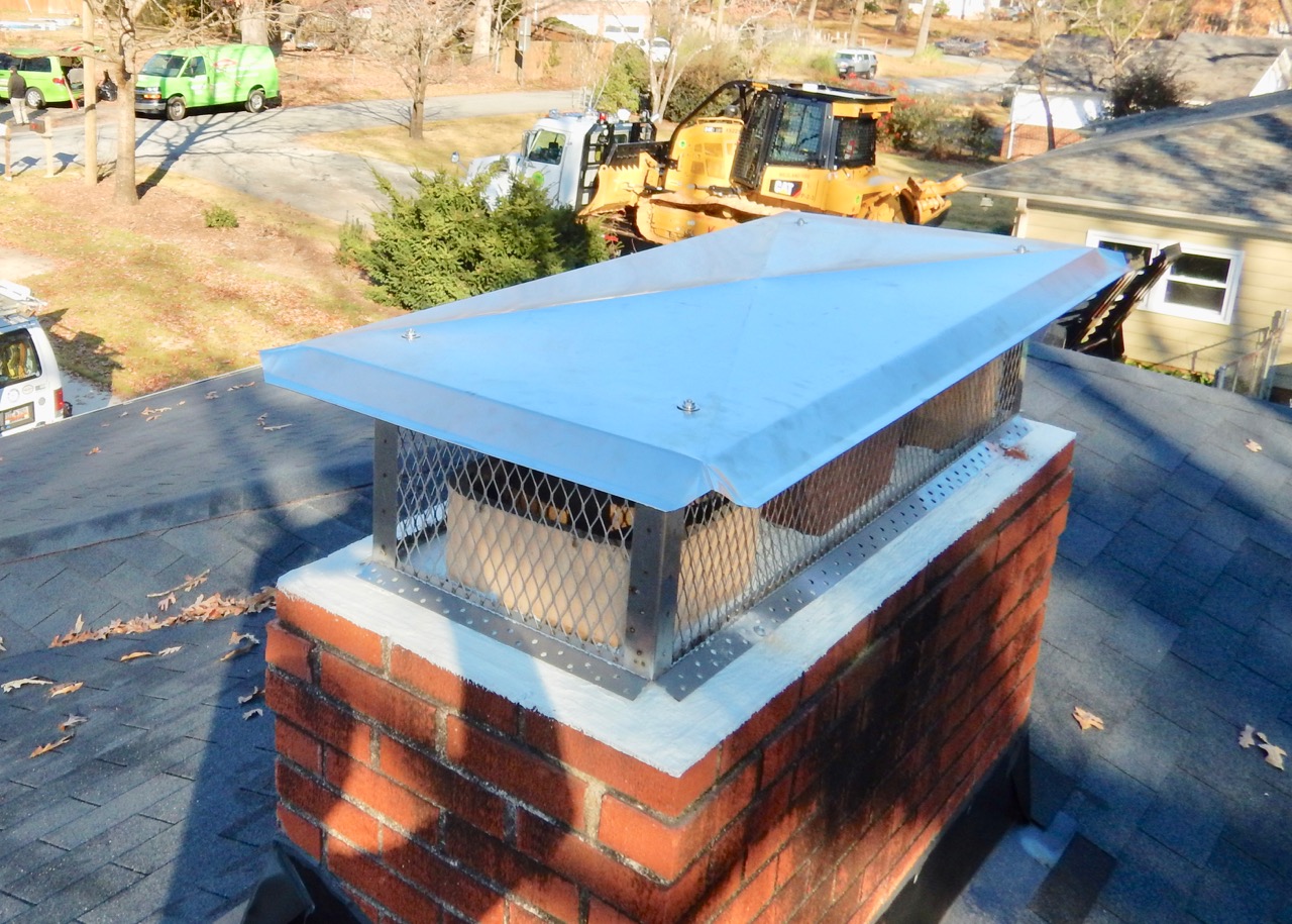

Another slightly more expensive option is a stainless cover outside mounted:
