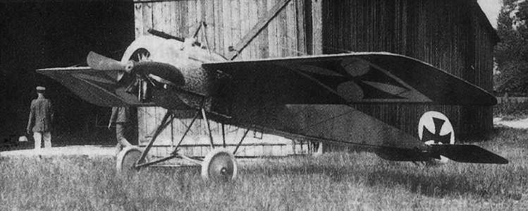

I think also materials and engineering of the time couldn't build a strong enough structure for a single wing to work.
Early monoplanes had extensive bracing wires. Cantilever (internally self-supporting) wings had to wait a bit.
Bleriot XI, 1909. Monsieur Bleriot flew it across the English Channel.
Fokker Eindecker, 1915. Also the first to have the synchronized with the propeller machine gun. The source of the "Fokker Scourge". Allied planes and pilots got the unfortunate nickname "Fokker Fodder".
Boeing P-26 "Peashooter", 1932. Became obsolete fast. Tractor monoplane fighters with cantilever wings, enclosed cockpits and retractable landing gear were pretty much standard by 1935.
