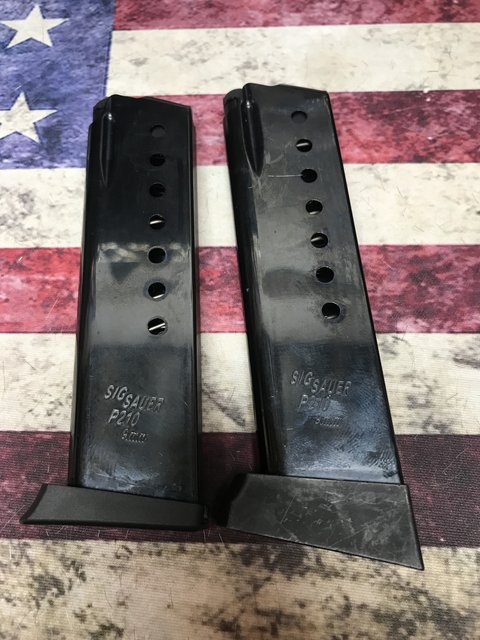

I have two extra mags that are marked Sig P210.
The one on the right is the proper mag for the target Sig P210 A. The one on the left actually works and fires in the same gun but since it’s shorter you have to guide it up.
I will be selling two of the left version and need to know what to put in the add as to what gun it is for.

They are the same. The only difference is the base plates. One is for a target and one is for a 210A.
Can you buy just the base plates? Didn't have much luck finding them.

KN Nill sells the base plates.
Do you happen to have a link? I couldn’t find them.

Try also mactecsales.com
You are looking item S192 or S192X8. Nill is not cheap. These are $60.00 and & $71.00 each.
You might try call Sig customer support @ 603-610-3005. This is all the help I can give.
Dang that's crazy since you can buy new mags cheaper than the baseplates.
