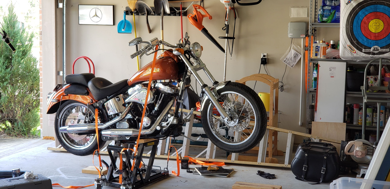

Getting the bike onto the jack was the first difficult task. Stood vertically, the Scout has just minimal clearance to get the jack under it. Luckily, the jack has d-rings on all 4 corners, so I was able to strap it down to keep it from tipping.
Start lifting the bike & only the rear is coming up. Pulled the jack & put the bike on 2x6s to get a bit of extra clearance & put a 2x4 on the front leg of the jack. This got it into a more balanced & favorable position.

That's a fantastic bike. I feel you on the pain of getting it on a lift. One of my bikes is a 2009 Sportster that isn't just low, one of it's exhaust pipes runs below the frame, making getting it lifted and securely balanced problematic. For routine stuff like oil changes I have started just using a couple of sections of 2x4 up under the kickstand to get it mostly vertical. I used to own a Yamaha that required removing the front exhaust to get to the oil filter.
There is a tremendous amount of satisfaction to be found in doing the work yourself though.
Having the proper tools goes a long way in doing it right.
With the Scout, there are 2 cross members on the bottom of the frame that line up well with the jack. I was just able to get the drain pan under the engine with how it all lines up.
I think it'd balance a bit better with the lift a but further forward, but then it would be pressing on the rear shock bodies & would limit access to the drain plug.
Long term, might be worthwhile to fab up a Scout specific bracket, rather than the 2x4 in the above image.
