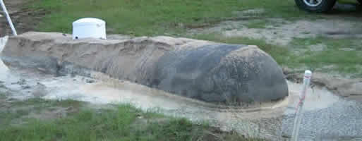

What did she do for buoyancy control on a the propane tank or was it 4' in the air too? The only reason I ask is putting a generator 4' in the air for a flood is useless if the propane tank floats and the resulting forces snap off your propane connection. You wouldn't believe the shit I've seen float in O&G that people never dreamed could float (e.g. sump tanks pop out of the ground, above ground storage tanks float, etc)
It was buried. I assume the ground would keep it in place. Tank was installed by propane company, never even thought about the idea of a LP tank floating.
She showed me a video from last major flood she had of water coming in the dryer vent, looked like a fire hydrant. I would have moved after that.
Need to install buoyancy control or it'll do this next flood:
There is enough uplift forces that a buried tank can breech even if under a concrete parking lot:
This isn't buried yet, but it's an example of buoyancy control system that still allows cathodic protection to protect all 360 degrees of the tank.

If she has another one of the 100 year floods that happen every 10 years or so she's not going to be a happy camper. I am sure that she didn't go through that effort, don't know for sure as the propane company set the tank and plumbed it to the stub up at the house for our gas guy to run the final segment to genny. Knowing this lady she may have asked them to bolt the the to the upper mantle for all I know. She had 3 feet of standing water in her yard so I don't think the tank would stay put after seeing your pics.
