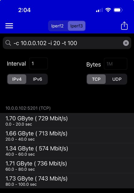

Since #1 son is home from college for spring break, I was able to use his computer wired as an iperf3 server. I haven’t messed with iperf before, but I think the results are good using my phone as an iperf client. This is using the Xfinity modem/router and the Netgear WAX625 WAP:
My other son started doing stuff during the 574Mbit/s one.
