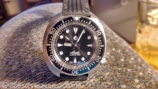

I purchased this Seiko homage watch some years back from a company in Indonesia. I wore it daily, and it kept accurate time, and I like the watch.
Last year I purchased another watch and stop wearing the Athaya, it was not worn for a year.
Now, I went to use it, and it will run for 15-20 seconds and stop running. Even vigorously shaking the watch, the second hand will only run a short time.
Sending it back to the company is a no go, and before I send it to a watch specialist, is there any thing I can do to get this watch running?
What could have happened for this watch to stop functioning ?

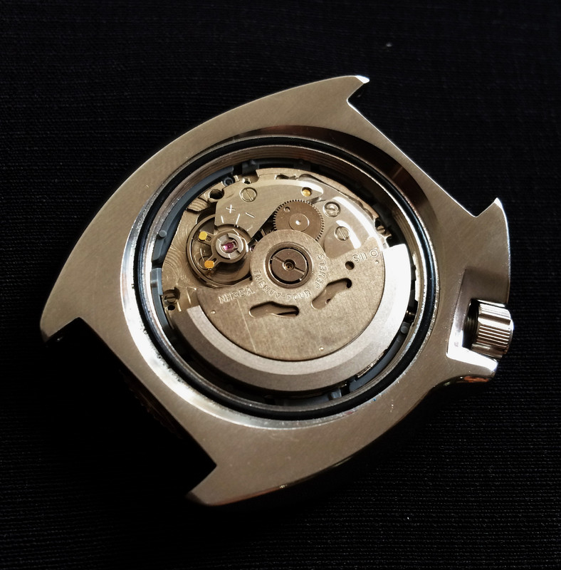

This is the movement:
Movement : Seiko Instrument Automatic NH35A Hacked second.

Probably shook the Athaya in a round motion about 1 minute each several times. Each time after those shakings, it still ran 15-20 seconds, then stopped. Each episode of shaking ends in the same results.
Large photo from Athaya's website of exposed movement.
