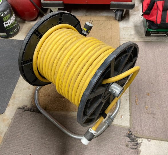

Extension cord story...
I have this 100 ft. extension cord made from marine shore power cord I'd bought for our boat. I'd bought it on the assumption it was a 30A (10 ga.) shore power cord. Turned out to be 20A (12 ga.) stuff. I went out, bought the right cable, and moved the 30A shore power connectors to it.
Thought "Hmmm... that 12 ga. stuff would make a great extension cord, but how to manage it?" A buddy at work grabbed an empty plastic wire spool for a reel, bent up some conduit to make a stand upon which to mount it, I threw on 20A connectors, and made it into a seriously kick-ass 100 ft. 20A extension cord Smile
Ensigmatic, that is a bad ass extension cord!
