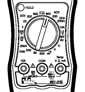

I have an Ideal 61-310 multimeter. With dial set on DCA at 10A, I have the red lead on the left side port labeled "10A" and the black lead on the center port labeled COM.
And then what? Have you disconnected one of your battery leads from the battery and and used your multi-meter leads to complete its circuit back to the battery, hopefully with jumpers with healthy alligator clips. In other words, do you have your meter leads in series with one of the battery leads?
The fuse is rated at 15 amps.
Which fuse? The meter fuse? If so, you say you're reading 20A but not repeatedly blowing a 15A meter fuse? Not trying to be snarky, just asking for some clarification.
Yes, I've disconnected the negative terminal and have my multimeter in series.
The 15 amp fuse is in the main engine fuse box.
Swapped out the stock stereo for a Sony. Also, an Alpine 45w power pack was installed sometime ago and it seems to be spliced into the stock Subaru wireharness. When I added the Sony, I simply spliced the Sony harness into the Subaru connection. I believe the battery issues predates any of my work. I had a low battery several weeks ago and I thought I had left on the headlights.
Interestingly enough, the owners manual for this meter indicates it is not fused for the 10A range.
https://www.idlim.net/media/pd...61-310_manual_v2.pdf
When you have your meter hooked up as you describe, and if you open the door, do the interior lights come on?
This is assuming the interior lights did work previously.
If they do not, the meter is misbehaving. If they do, make a note of the reading. Interior lights generally do not exceed 10A.

Originally posted by Russ59:
I'm not seeing a steady amp draw of a few amps. I'm seeing an escalating amp draw to where it exceeds my meter setting. It starts at 3 or 5 amps and quickly tops out at 18-20 amps. I believe I'm performing the test properly. I have an Ideal 61-310 multimeter. With dial set on DCA at 10A, I have the red lead on the left side port labeled "10A" and the black lead on the center port labeled COM. Am I doing it wrong?
Assuming that
the meter switch is set to "DCA 10", the red lead is plugged into the "10A" jack, the black into the "COM" jack, what you're doing is removing the one fuse and touching the meter leads to the two fuse-holder connections: Yes.
But what you're saying isn't making sense. Being as the meter is rated for a max of 10A (thus the instruction manual pointing out it's a max of 10A and it being clearly printed on the meter as a max of 10A), I'm hard-put to see how it's measuring up to double that.
You disconnected what "negative terminal" where?
If the circuit was fused at 15A and something was slowly ramping-up to a 20A draw, it'd be blowing that fuse all the time. As in: Every time a new one was put in.
You're doing something wrong.
You sound like my wife! Wink Wink
Yes, I suspect am I and thought I may be wrong when I was getting that run up in amps. However, if I was consistently wrong procedurally, can I still suspect that fuse (No. 2 in the main fuse box) as the guilty circuit? It's the only circuit that didn't give me the run up in amps when I did the "pull each fuse separately" test.
I will try again on Thursday. Thanks for the response. I'll report back when I've got boots on the ground and not picking on CA bureaucrats.
