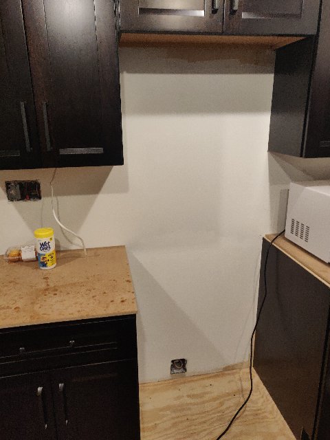

Thank you all for the input. It is an electric stove/convection oven. The wave will stay on the counter. So far as the hood, I can see a metal vent going up into the cupboards above - I’m just trying to figure out how hard it could be to tie it in.

I don't know if this helps but it's a picture of what we had to do. We have a vaulted ceiling in our kitchen. Because the studs are directly in the center the actual vent pipe needed to go around the studs and be hidden. So our builder put this bump out that our vent goes into.

Holy shit! That’s awesome- and way out of my league, lol. I like to cook, but I’m nowhere to that level.
We had already decided to keep the cupboards above so I might do a modified version of that. It’s just 4” closer to the stovetop than what I’m used to. As y’all know, that can turn out to be more than you might think..
