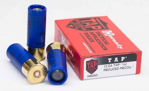

While it still won't be quite down to 20 gauge recoil level, there are a number of different "low recoil" 12 gauge loads offered by various shotgun shell companies that cut down on the 12 gauge shotgun's usual thump.
Federal, Fiocchi, PMC, Remington, Winchester, Hornady, etc. all offer these "low recoil" 12 gauge loads.
They'll be noted on the box as "low recoil", "reduced recoil", or "managed recoil" loads. Some examples:
