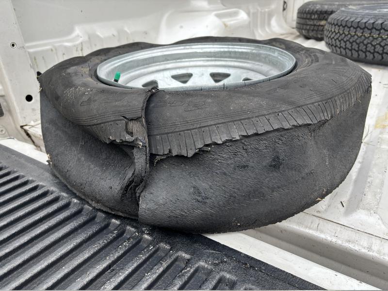

Three year old tire, always stored inside, and less than 400 miles on it including only 200 today. Should have been in Tennessee by now, but I just put the spare on, turned around and went home. Tomorrow, I have an 8:00am appointment at Discount Tires for two USA made Goodyears.
This is my sixth China bomb on now a fourth trailer. This time my single axle boat trailer. My fault and reason 448 I am not a pilot. I know better and should have replaced the tires beforehand, but just decided to go for it.

Dumb question: was the tire like that (no tread left) when you started the trip? Or is the tread gone because of the blow out (dragged the tire moving over to the side of the road or something)?
Posts: 14779 | Location: In the gilded cage | Registered: December 09, 2007Reply With QuoteReport This Post
Not that dumb a question. Chicken or egg first?
Somewhat obviously I hope, I certainly didn’t leave my house this morning on a 1,600 mile trip with a tire that had the entire tread and associated radial plies missing. What you see in the picture is the two plies, layers of cords, that make up the tire’s carcass from bead to bead. What is missing is the two or three radial plies that go around the circumference of the tire under the tread but above the carcass. As I said in my OP, the tire didn’t have 400 miles on it when this happened. It looked new when we left this morning.
Now the chicken-egg, did the tire blow and then the tread separate or did the tread separate and the tire blow? I think the tire blew then the tread came off. When I heard it, I immediately pulled off the road. My son and his buddy were following me in another vehicle and pulled over as well. The tread was in the emergency lane and not the road when my son dragged it into the grass.
Of the six China bombs I’ve had, the is the first where the tread and radial plies separated.
It just happened without warning, BOOM! I didn’t hit anything. My son and his buddy didn’t see anything until they heard the explosion and saw the tire come apart. At the rest area we stopped at 10 minutes before, the tire looked normal, didn’t feel hot, really felt the same temperature wise as the other tire. I suppose I could have broke out my infrared thermometer, but I normally just use the back of my hand. Since we aired them up before we left and hadn’t gone even 200 miles before the first rest stop, I didn’t check the tire pressure.
In the millions of miles I’ve drive, I’ve never had any other tires blowout, just the 6 China bomb trailer tires. I’ve put tens of thousands of miles on the tires I’ve replaced the China bombs with and had not a single problem. The longest I’ve had a new trailer go before a China bomb is 1,500 miles.

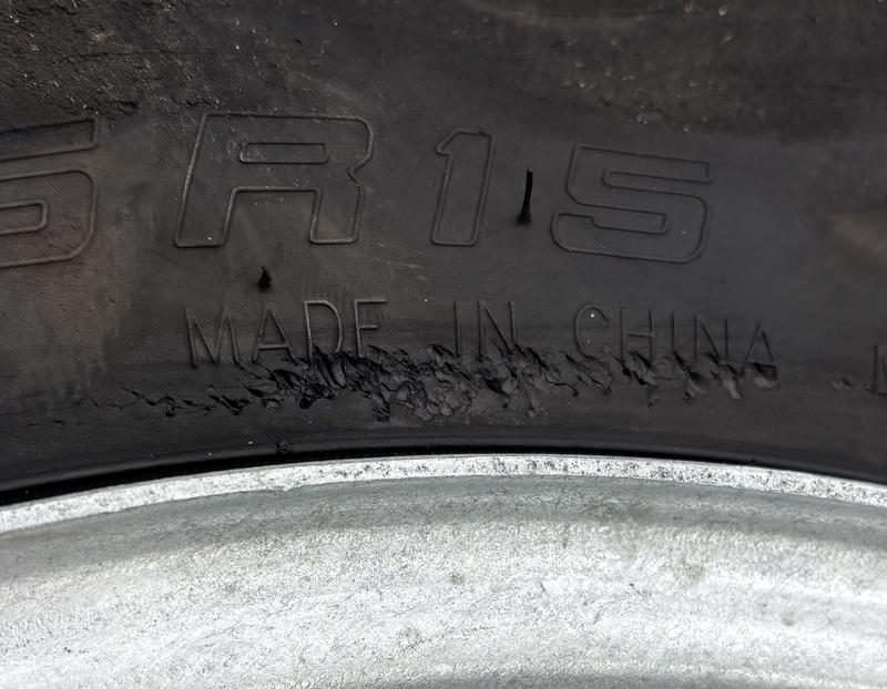

Goodyear G614 trailer tires. Holy crap, they are expensive! But they'll outlast 10 sets of Chicom tires.
Great example. My 5th wheel came with China Bombs. Made it 1,500 miles before one blew up. It was our last camping trip in Florida before we’re going to take it to Michigan and an had planned on replacing the tire before that trip.
At the time, the same tires it came with were $60 and weighed 33 pounds. A name brand Chinese tire was $100 and weighed 39 pounds. The G614s were $300 and weighed 61 pounds. I went with the G614s
