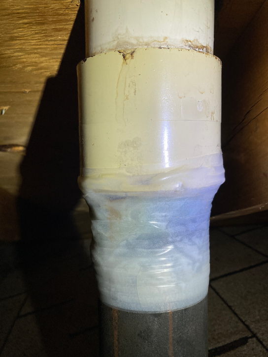

Update
Much as I suspected, here was the culprit:
As you can see: I had indeed sealed it up, once, already. Apparently not well enough.
I hogged-out the area where the water was coming through, squeezed some new sealant in, and taped the whole thing. (Hint: For that tape to work it has to be stretched really, really, tightly.)
After:
This is just a stop-gap. You can't see it clearly in the photo, but water still wants to get in there and creep down between the tape and pipe. Hopefully I either stopped it or at least slowed it down far enough it won't be a problem.
To seal it for good will have to wait for warmer weather, when the water isn't flowing. I'll have to remove all the current tape and sealant, re-apply sealant smoothly, let cure, then tape.

You should be able to get a Fernco coupling in the right size to seal that properly. Should look like this and comes in many variations:
^^^ absolutely!
They come in Cast Iron x PVC sizes.

Thanks for the hint! When the weather's more conducive to fixing it properly, perhaps I'll do just that. For now: The dribble is stopped (I went up and checked after dinner--dry as a bone), so I'm gonna call it good for now.
