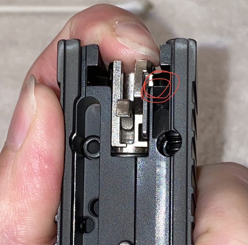

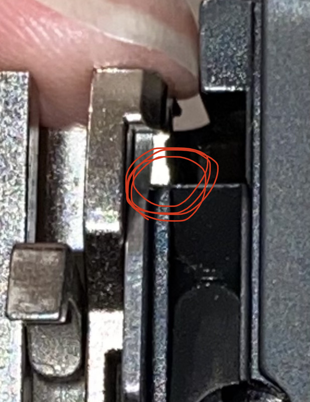

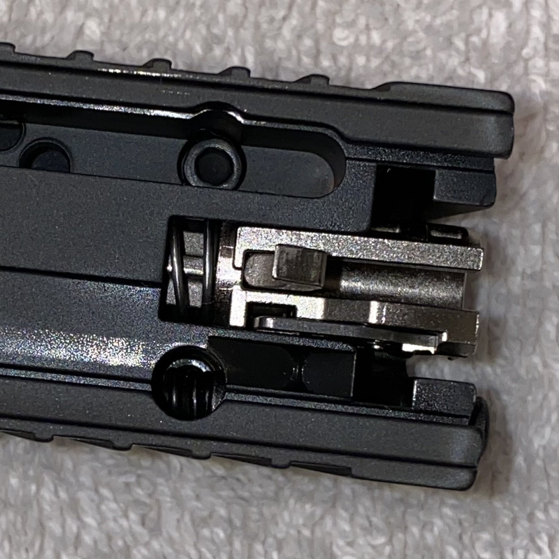

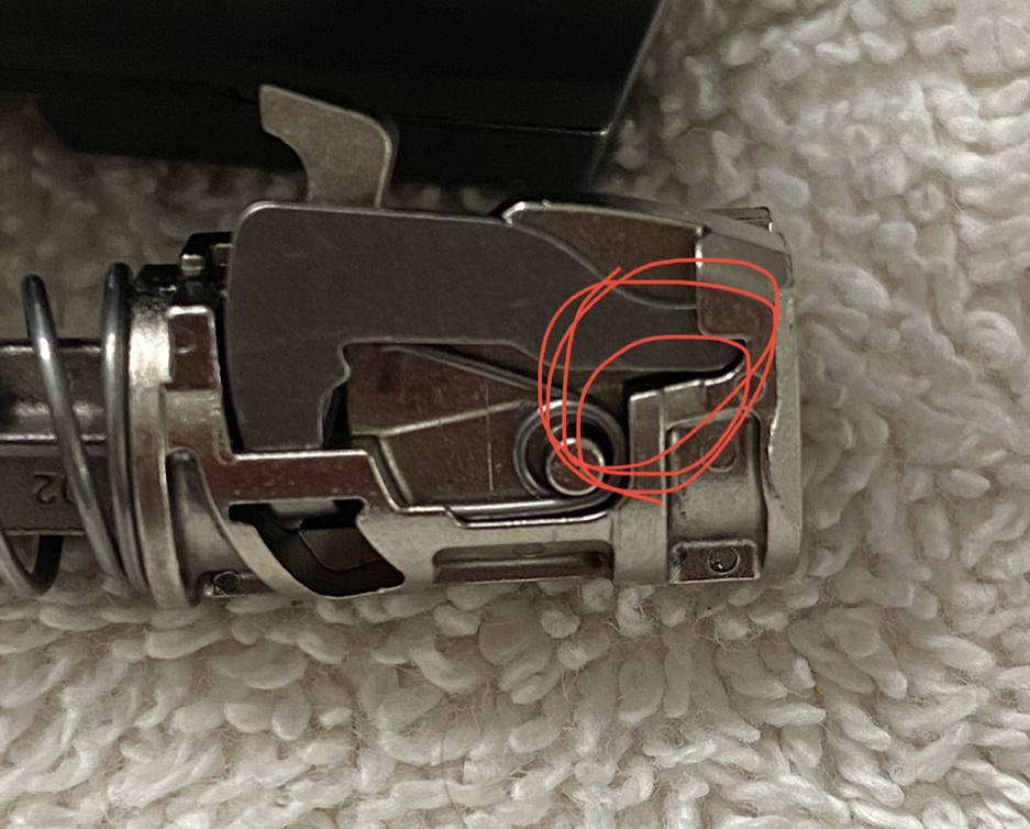

I removed the striker assembly from the slide to clean. I did not disassemble the striker, I just removed it from the slide. I can't get it to push down so I can slide the back plate back on. I watched numerous videos and it doesn't seem like major force should be needed to push down on the striker assembly in order to slide the plate back on. I have a P320 XFull. I added pics. That's as far as it will go.

Assuming I’m interpreting what you’re circling correctly, it appears that part of the striker housing is contacting the slide next to the disconnector cut and preventing the striker assembly from being pushed in properly. Is that what you’re indicating?
If so, the striker housing is a single piece and the projection that appears to be causing the problem is part of the housing. If the assembly and housing were installed in the slide before, then something must have happened to move the housing over so that the projection can’t slide fully in.
At this point I’d check to ensure there is nothing in the striker assembly channel in the slide that’s pushing the housing to the side. If it’s clean and clear of any debris or burrs, then I’d just making sure I was pushing the housing away from the obstruction point (I assume you’ve tried that, but …). If pushing to the side doesn’t work, try rotating the housing clockwise as seen from the rear.
It also appears that the part of the housing that’s causing the problem is where the rear of the safety lock is inserted. You didn’t do anything with the safety lock that could have put pressure on the thin part of the housing at the rear and bent it out—?
Finally, though, when I played with my P320XCompact, I noticed that the striker housing wanted to hang up on the striker a bit when I pushed the housing forward. You might pull the assembly out of the slide and check to ensure that the housing moves freely when it’s pushed forward on the striker to compress the striker spring.
Otherwise, I don’t know what to say. The striker assembly was in the channel before and something must have changed to make it impossible to insert now.

It's fixed! I had posted on a women's CC FB group and someone helped me through it. Turns out the spring wasn't in the correct position or maybe didn't have enough tension. I twisted it around a little and VOILA! All is good now. I did a few trigger tests and it seems to working well now.

Yes, the striker spring. Even though it looked like it was getting hung up on housing in that picture, it wasn't. Must have just been the angle the pic was taken at.
