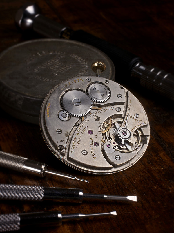

Well…. We are about to go waaaayyyy down a rabbit hole!
Doing the Seiko modifications, or even starting with a bare case and movement was starting to feel a lot like “building” an AR. Not that there’s anything wrong with that! But really, it’s more like “assembling from components” than “building” or “making” if that makes sense?
So, hey. Why not go all in and get to capital B building a watch?
So they say, start with a pocket watch, since they are bigger, and you can find non working movements cheap…. Sounds sensible. If the word “sensible” is even remotely applicable when used in the context of me doing intricate, delicate, teeny tiny work requiring tons of patience.
A little bit of eBay time, and then waiting on the USPS, and I got me my first victi… I mean candidate for treatment. A Gruen Veri Thin pocket watch.
I might not be able to fix it, but I will probably be satisfied if I get it all the way apart, cleaned and back together with no more than one or two extra parts left over.

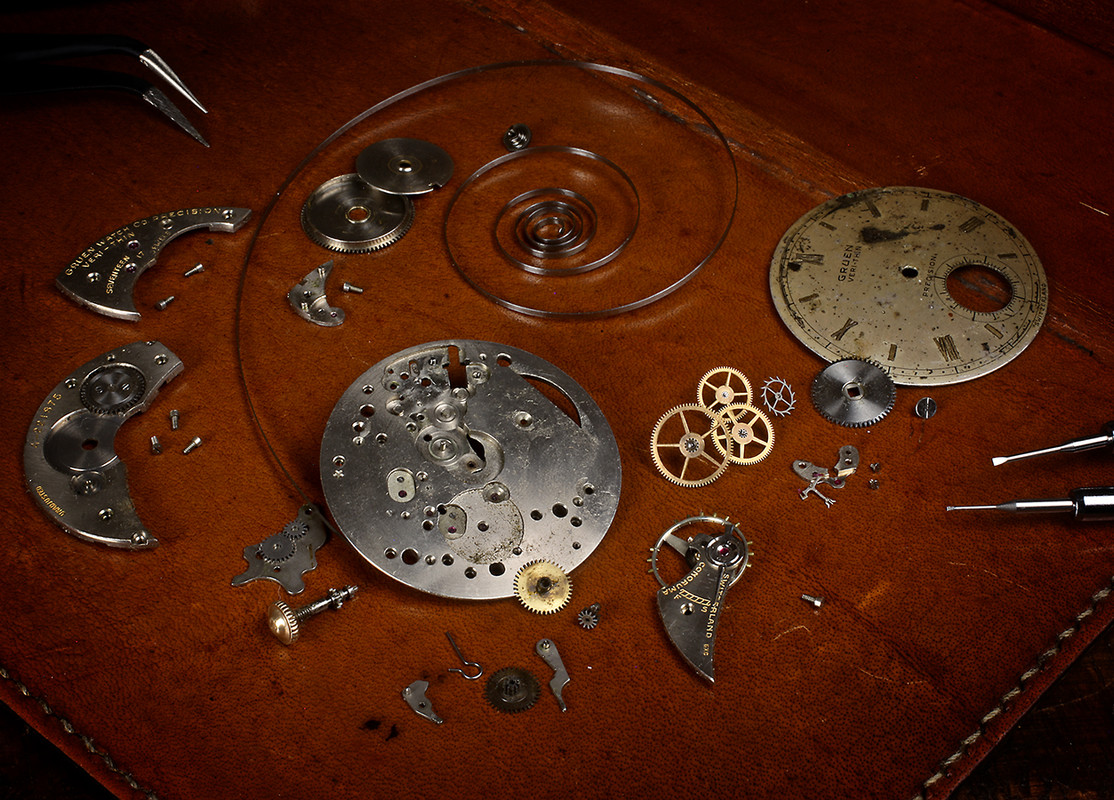

Got it!
At least all the way apart. Minus one extra super tiny screw I don’t have a screwdriver to fit. Holding on a bit of metal that does…. Something. Or other.
But, found a kink in the mainspring that I think might have been a problem. Cleaning everything up now, we will see what happens when I get a few hours to try getting it back together.
Absolutely amazing the sheer scale of things on this. Screws almost not visible without magnification, I did everything under 10X and felt I needed more.

Be careful when you clean the parts. Don't use a solvent or the pallet fork jewels will come off.
All these parts should have been put in a basket so you won't have one fly off into oblivion.
That balance really should be on a balance stand.
Eeewwww, don't touch it!

stylophiles, Excellent work!!! That is impressive. Do you think the main spring can be repaired or replaced?

Most Gruen movements have the caliber number stamped on the pillar plate. Get that and let me know, I can look it up for you and give you a mainspring selection. Also, be very careful with the click spring which goes under the ratchet wheel. Gruen cuts a very shallow "groove " for it and it loves to launch.
Good Luck.

I actually have all the parts in a numbered tray with a cover, this was just for the photo!
Funny you mention the pallet fork jewels, one of the videos I was watching made mention of the fact that shellac is used to secure them in place. Got a lot of experience with shellac doing vintage fountain pen repairs, and for some reason I never really thought about just how many other things it must have been used for back then.
Didn’t even think about a balance stand, since I’m not sure just how into this I will be getting, but it looks like they are pretty cheap, so… might as well hit up amazon or eBay!

I got lucky, no launches during the process, and the only thing dropped was the center wheel, which went down into the movement holder when I pulled off the cannon pinion from the other side.
Thanks, I will let you know about the mainspring, since I am really just using this for disassembly/assembly practice I might not worry about buying parts. It came without a case, hands, or the inset seconds dial, so it would be a long road to actually restore it to use.

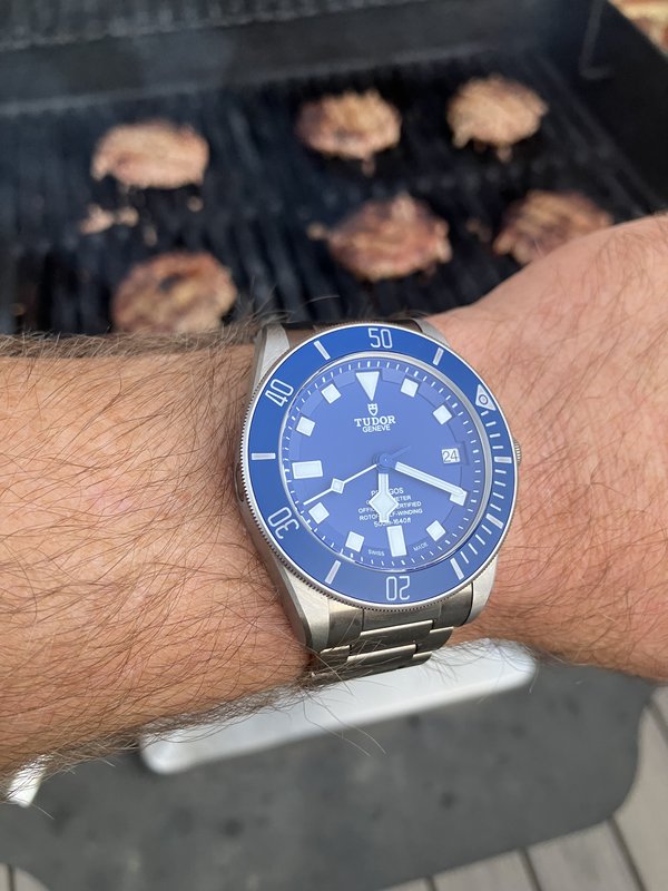

This watch is so damn comfy. It’s easy on the eyes too.
The LHD might be my favorite watch(depending on my mood) but it’s in a close fight with the Pelagos blue. Wink
I love this watch. I can’t wait to take it to Greece next year. (It’s named after a Greek Island)
